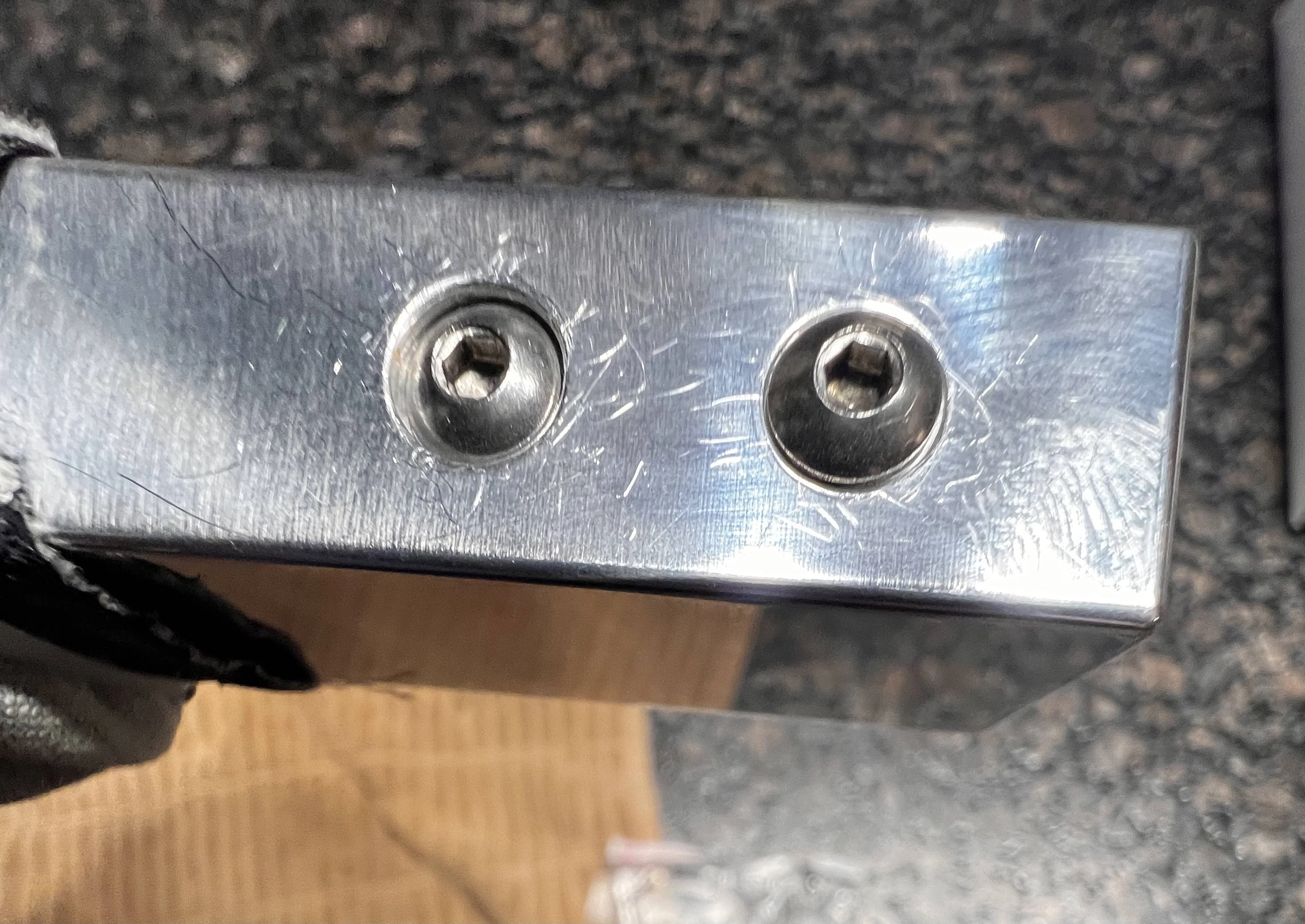

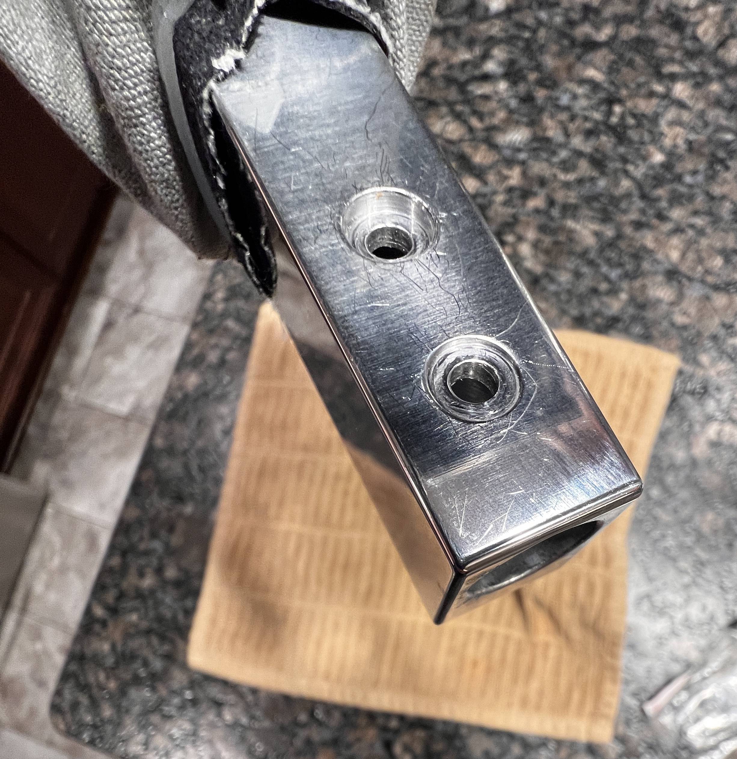

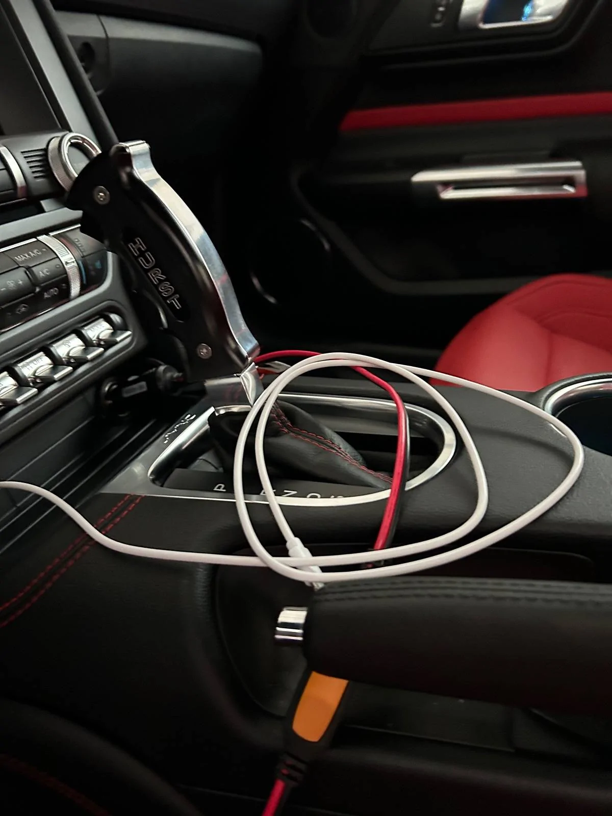

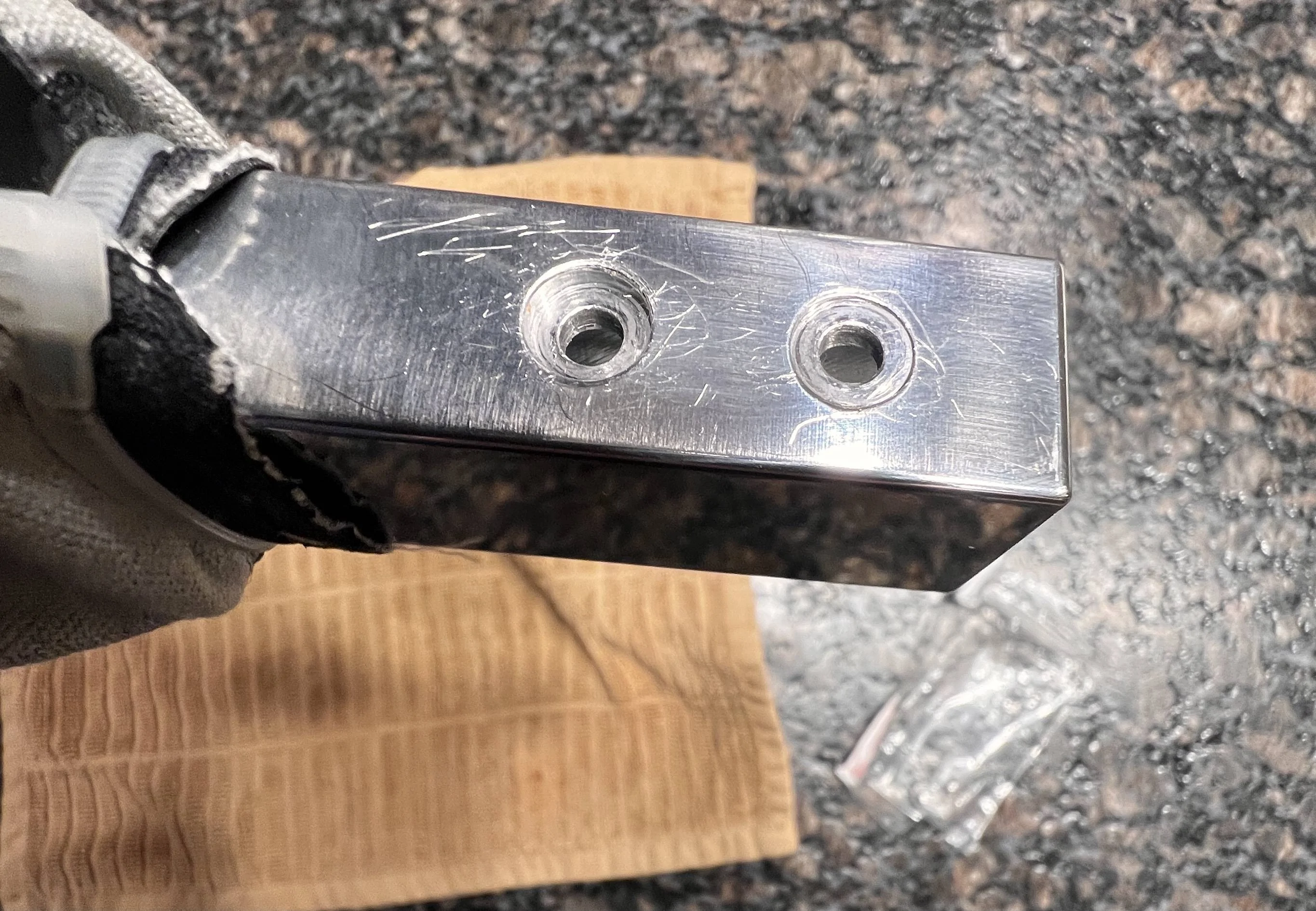

Very disappointed in the quality of the new Hurst shifter I purchased for my S650. Holes are off so for them to line up you have to lift the shifter up which results in the trigger not fully engaging with the shift rod which allows the shifter to be moved into any gear without depressing the Hurst handle trigger. Second issue are the holes which one is not countersunk enough and threads in by one thread into the Mustangs shift rod. How can Hurst’s quality control be so bad? I’m calling them Monday asking for a new one to be overnighted to me so I can reassemble my center console and drive my car. Here are some pictures of the Hurst shifter handle holes.

I left one of those reviews. I had the same issue with one of the holes being sunk too far and pinching the rod. I had a small washer I put in it to fix that. Every screw on the handle was loose as well so I had to tighten those up too. It is a good looking handle though and feels much better than the OEM knob. The button placement on the OEM just doesn’t feel natural.
