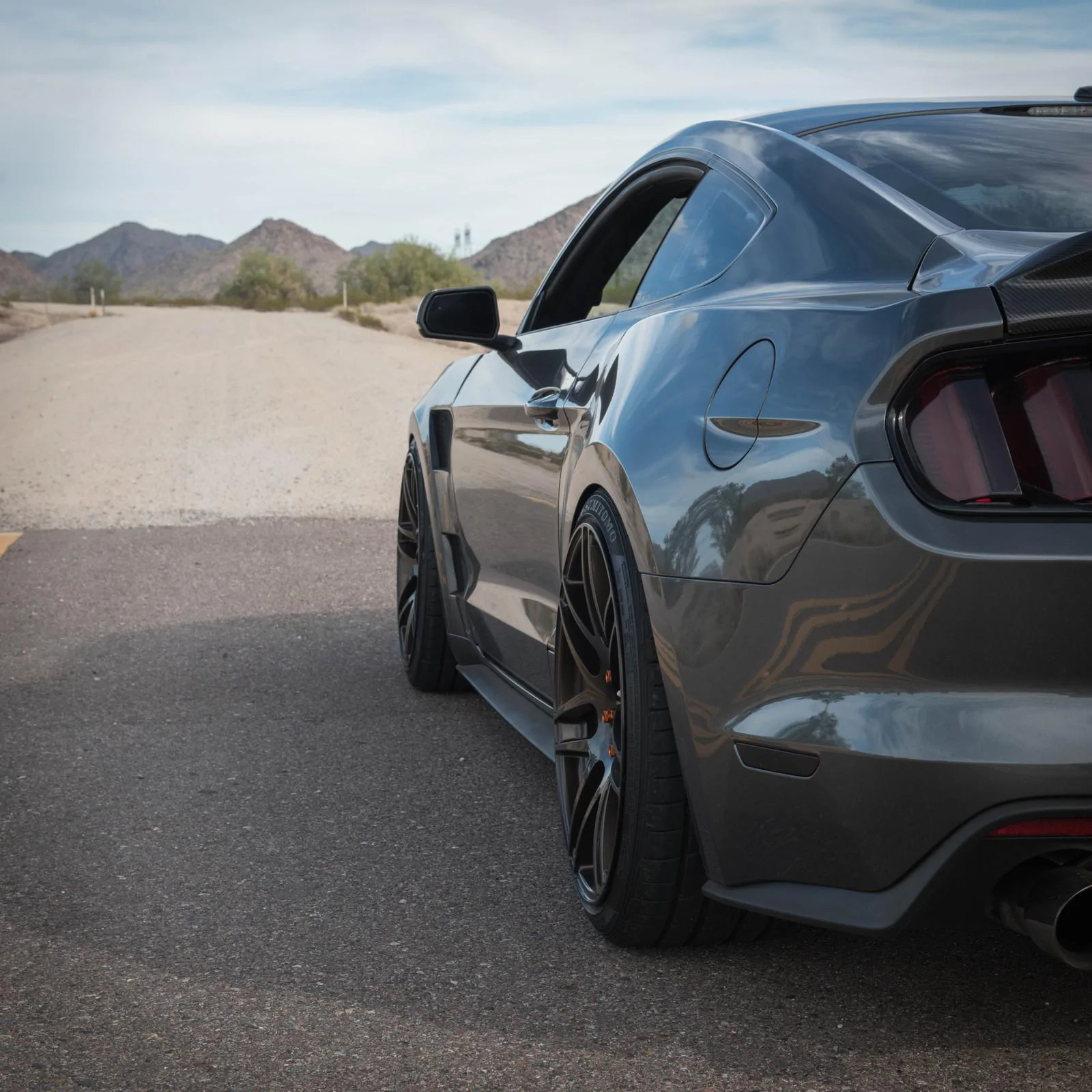

nikaf10
Jan 15, 2015
70
Phoenix, AZ
Nik
2015 Mustang GT
Sumitomo htr z II's. Just enough stretch to get a good fitments but not so much that I have to run higher tire pressures.

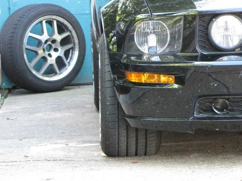

Actual dimensions for the specific tire make & model matter more than wheel diameter or 5 points of profile (as far as the 'stretched' appearance is concerned). 285/35-18 Michelin Pilot Super Sports (10.2" claimed tread) are about 11.8" wide when mounted on 18 x 11's. Forgestar F14's in this case.
The sidewall rub strip sits outside the wheel flanges by about half a mm (feeler gauge measurement).
