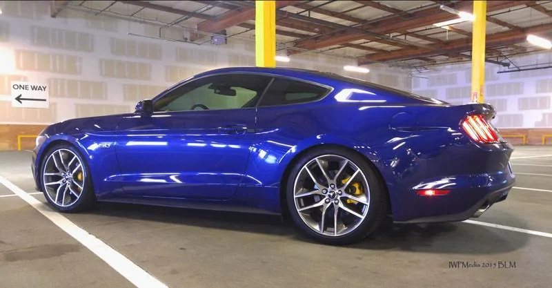

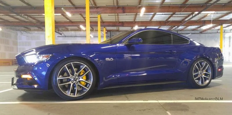

nice pictures hawkbox! what're the specs for that drop?
hawkbox
May 15, 2015
462
96
Arizona...in the heat
'18 GT Premium PP
Thanks!
I did just about 2 inches up front and I believe the spring perches in the back were just a hair shorter than they came so it was probably about 2 1/4?
byklin
Oct 9, 2014
495
75
2015 Magnetic GT
Thanks!
Are you talking threads? Like 2 inches of thread left? Give us a front shot! Haha
ok, sorry for the delay...
In the front I used an electronic caliper and set the threads at 2.5750 inches inbetween the rings.
