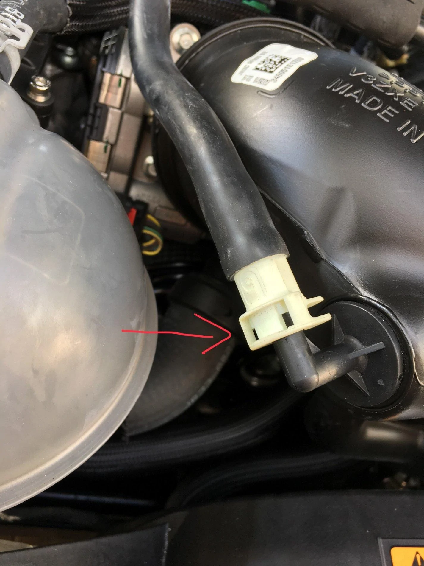

The plastic tab that is inserted to this piece to lock it.

Good luck with that . You will have to replace the whole line . For some reason ford does not service just the retaining clips .

Just fish a small tie wrap thru there and it works the same as the clip, that's what I did. You just have to cut it to get the hose off so the tie wrap is a one time use.
