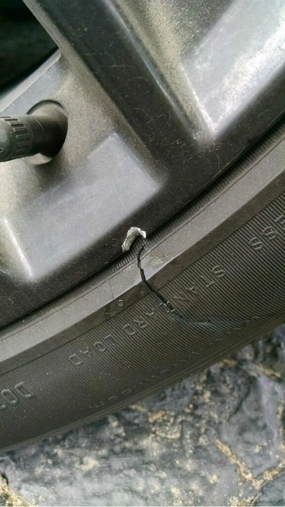

Honestly I run a 255/30/20 on a 9 inch vossen and it's extremely skinny for the wheel. No wheel protection at all, and after an incident a few weeks ago I really wish I would have went wider. Could have easily done 275.
