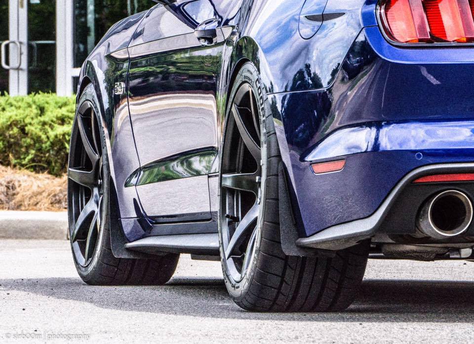

My car on MRR GF6 and later Project 6GR wheels. Give you idea of silver vs. black.
...and then a nice example of the greatest car ever made.
Need4SpeedMotors
Nov 17, 2014
195
21,606
5,150
Los Angeles, CA
www.n4sm.com
N4SM Team
That Conti Oh my :love:
And the 6gr wheels as well
I mean on DIB you can do black and or the charcoal for the RTR would pair very nicely as well.
Its like how our Satin Graphite 6GR wheels look on the DIB but the RTR are a few shades darker.
