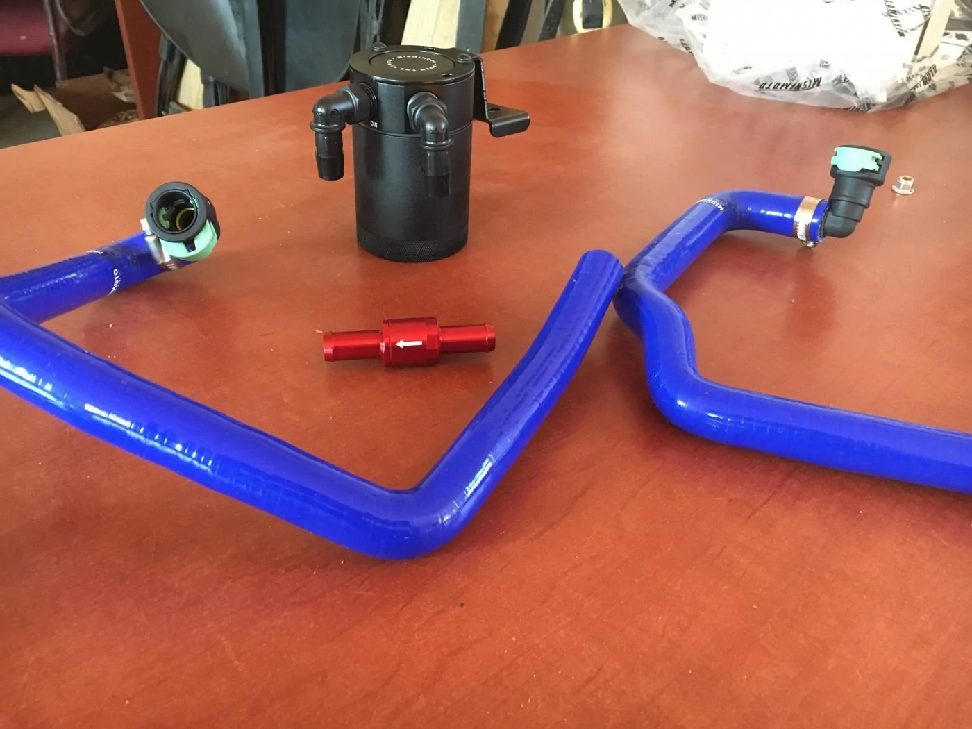

I have a mishimoto catch can and boomba check valve .. What way is the arrow suppose to be facing? Does it go on "in" or "out"?

check valve goes on the line between the intake manifold and the catch can
arrow points toward intake manifold

Don't forget to gut pcv valve

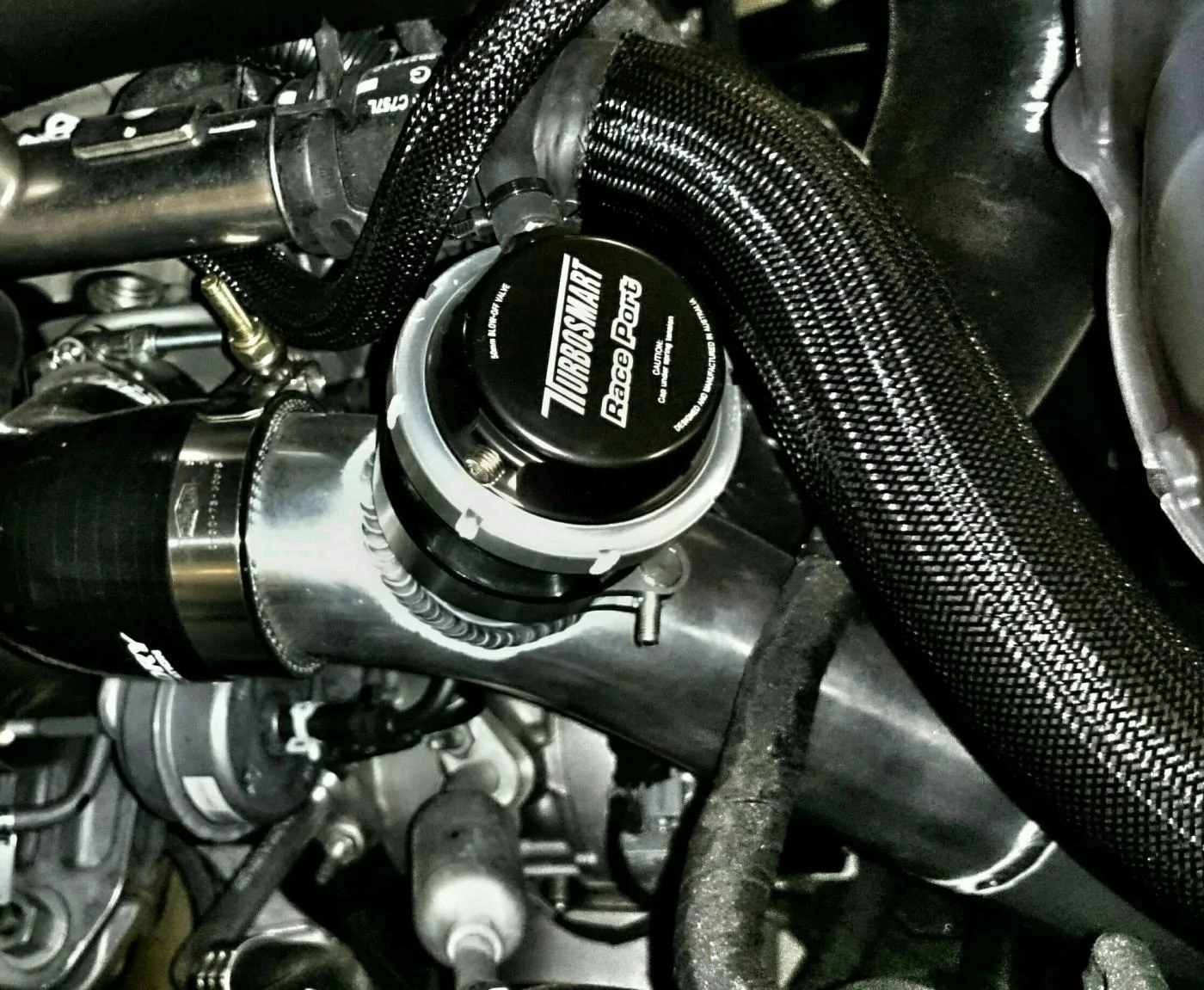

Speed factory in Tacoma installed it for me... I told them I wanted a turbo smart BOV and that's all they had in their shop.. Lol
