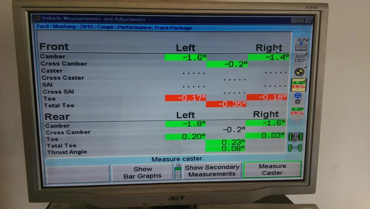

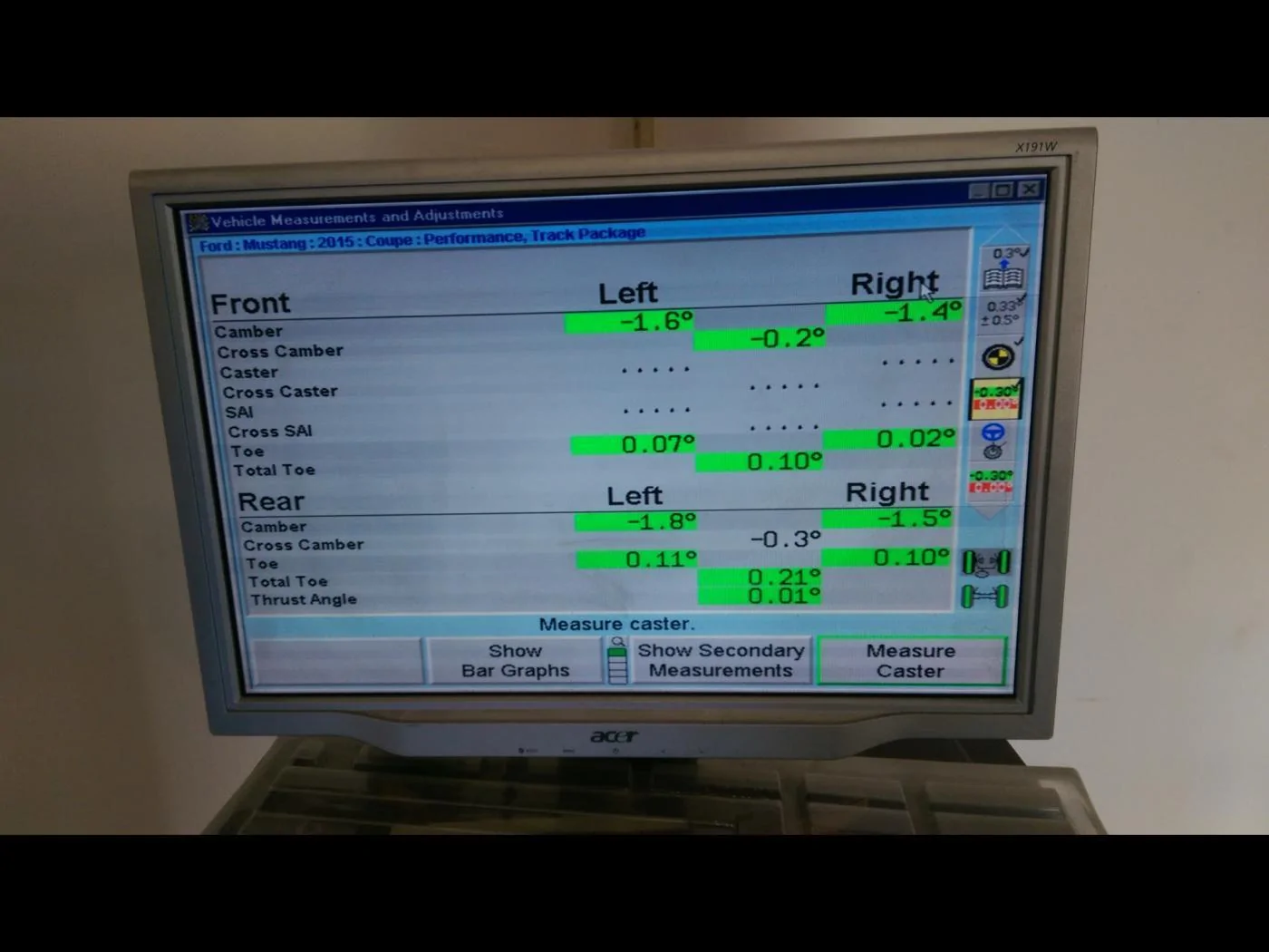

I have Steeda progressive springs so my drop is not as much but still pretty close.
Here are my final alignment specs that Steeda did that you can use for comparison.
You can see I am running -1.5 to -1.8 degrees of camber.
Where did you take yours to get aligned after the springs?

Hey Todd, mind me asking, I want to get the progressive springs, are your alignment specs close to stock?
I live in the Atlanta, GA area and drove 4hrs away to Valdosta, GA at the Steeda location. They did all the install of their parts and alignment at their shop.
Hey. They are. Here is the alignment right after the install of the springs for comparison. I don't know what my specs were after the car was delivered from the factory but someone might be able to chime in with theirs for comparison.
