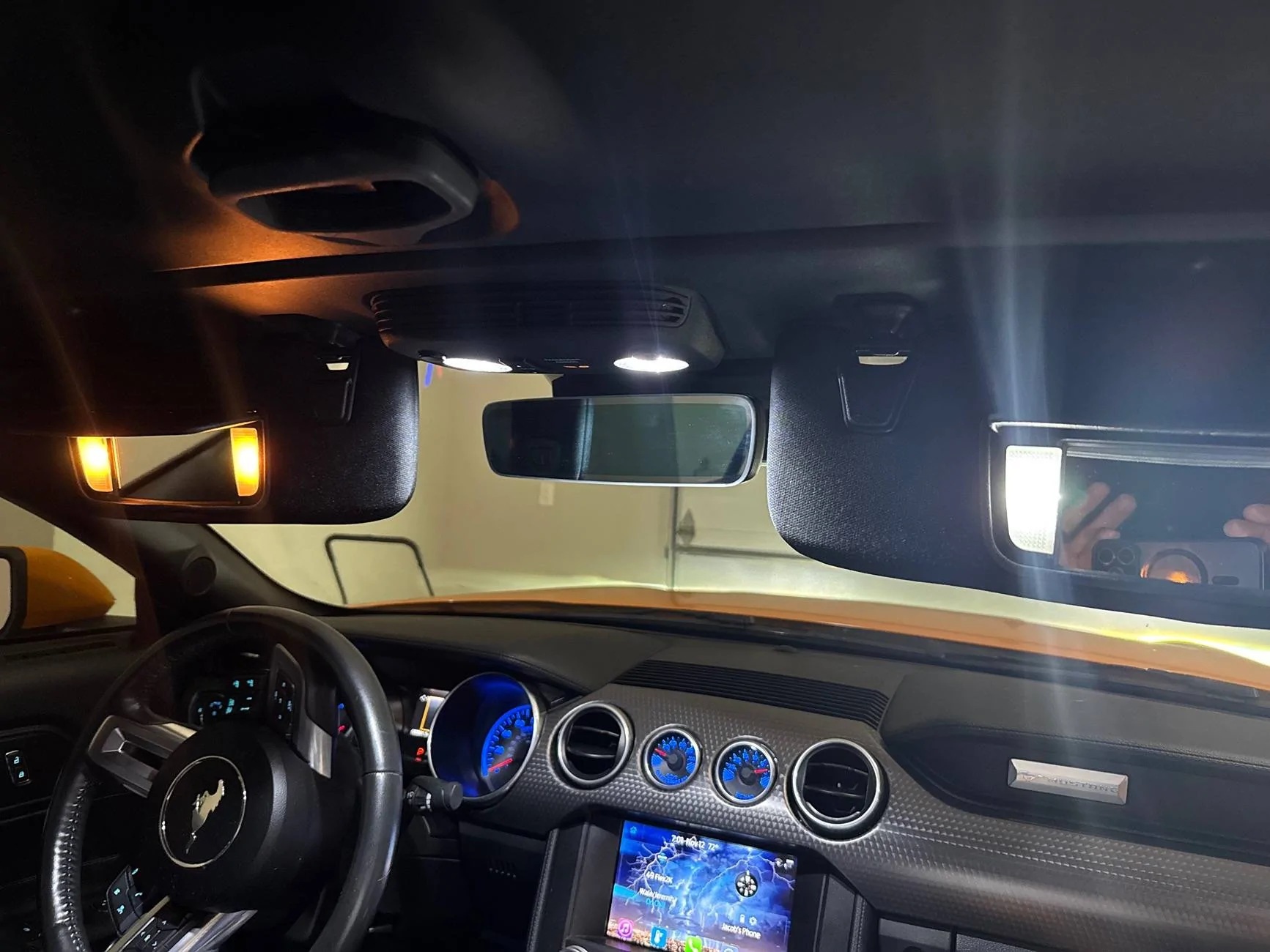

I’ve got a 2019 convertible and want to get rid of the dull yellow dome and visor lights. The only problem is that I keep finding the kits for the non-convertible and I know the lights are different locations. Does anyone actually know the size or numbers needed to upgrade them?

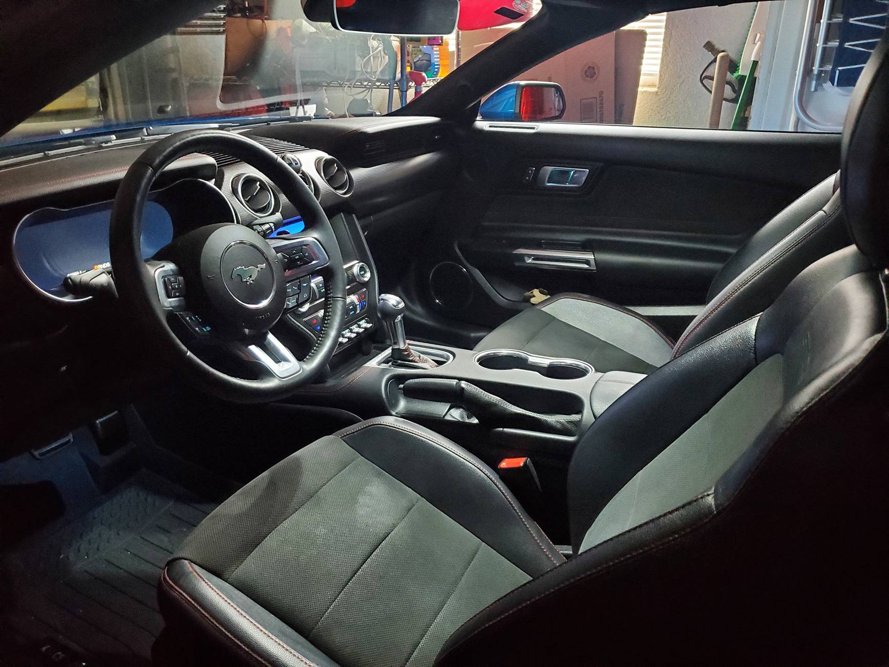

Here are the dome lights in my semi dark garage.

I was pretty fortunate. I was able to get the map lights and the visor lights removed without much problem. The biggest issue was with the visor lights. The LED lights were having trouble making a solid connection so I had to pull the plastic socket out and then bend the pins out slightly in order to make full contact with The LEDs. They were super cheap and I have like eight of them left over… Lol. Big difference after swapping them. The picture is with the center map lights changed and only set of visor lights to compare.
