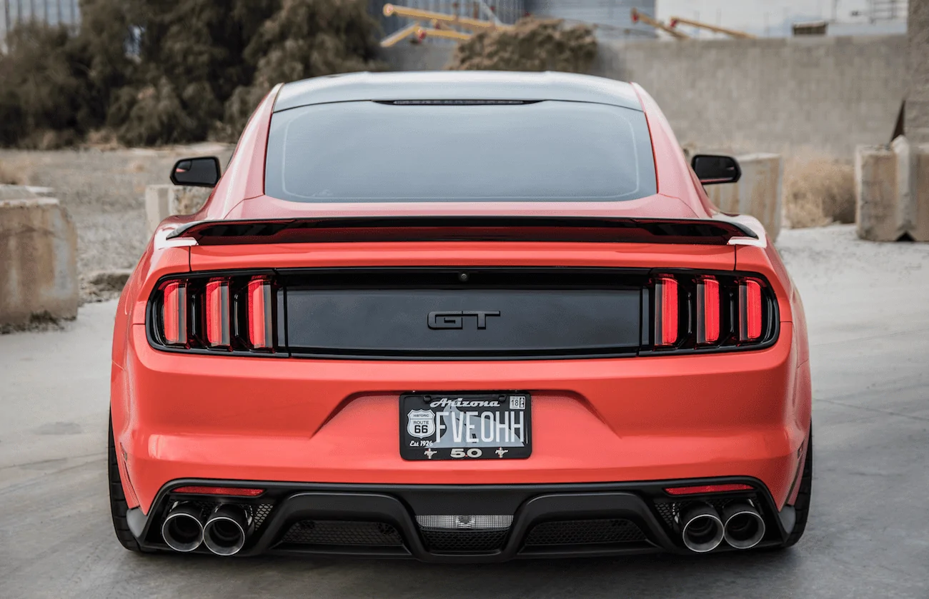

So I'm thinking about buying a gt350 rear bumper and getting a quad tip setup for my v6.
Currently I'm rocking the Magnaflow Competition cat-back system.
I need some help deciding on how to do the conversion. Is it possible to cut the stock welded tips and weld quads in their place? This is the main idea thats in my head but I want to hear ALL of my options. I'm sure some of you have done this before so any suggestions will help!
Thanks
Is it possible to go quad tips with your current magnaflow competition setup? The answer is no if you're thinking about cutting the tips off and welding quad tips on. There is not enough room between where the valance sits and your mufflers to make it work. How do I know? I was thinking about doing the same thing as you but couldn't. There is another option to make it work which is very costly and will take a lot of modification to make it work. :cheers:
I'm pretty sure i'm the only one currently running this setup and will be making a separate post about the whole process pretty soon! Oh yeah and the exhaust is ran straight through the valance on my setup instead of the fake tips that actually come on the valance.
