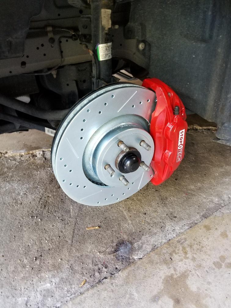

I unbolted mine but left the brake lines on. 2 hours with G2 paint, new rotors and Stop Tech pads and we're done.
