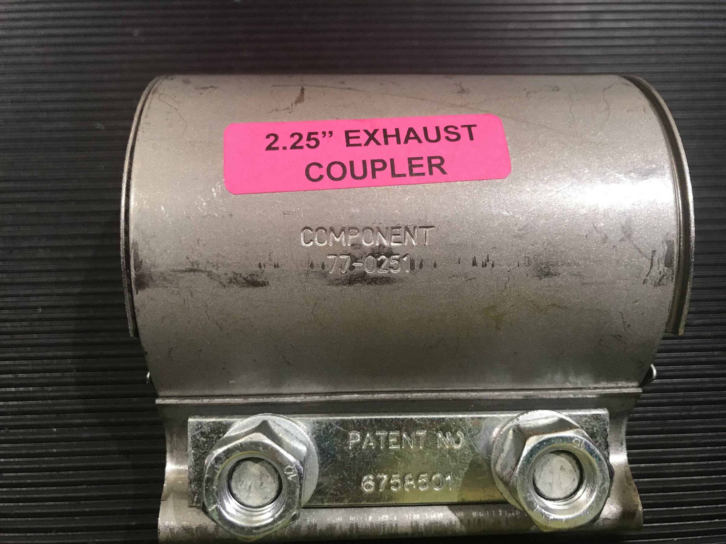

2nd time in 2-3 weeks...... kooks headers (stock connection size) with steeda h pipe. Installed with my big impact last time. My daily is on the lift at the moment getting a new front suspension so its not a opportune time for my pleasure car to need attention as well. Im planning to take my calipers to the OD of both the connection pipes and the steeda h pipe. Maybe there is a significant enough difference between the two that the clamps cant bite down good on both pipes.

Your sleeve clamps are stretched. Order a new set, and don’t use an impact on them. My 2016 original ones stopped holding over the years with my Kooks headers and connection joints last year. New set of OEM sleeve clamps and good as new.

Im going to order the new clamps for now. That or order the lethal performance corsa double h and the 3" kooks connectors.

Summitt & Oreillys have them, think the latter has them on the shelf?
20 - 30 ftlbs

The ford ones? For the connection right off the headers. Or any similar 2.25" clamp would work?

Just ordered the kooks 3" adapters for the headers to remove the 2.25" choke point and also ordered the corsa double h resonator delete. Both are stock items so i hopefully should have them in a few days.

Good news is CORSA uses Accu Seal clamps.
