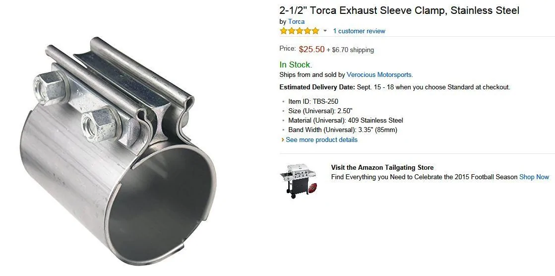

And here are some good clamps to marry up the OEM Ford resonator with the pipes previously cut, in case you decide to go this route.
(BTW...I did this myself and it sounds great. The Borla S type with H-Pipe was too loud for me)
