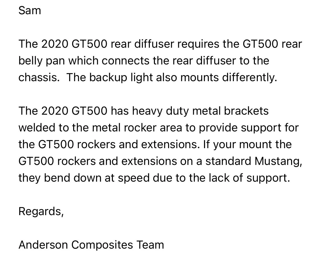

So I was toying with the idea of using the 500 rockers. After some visual inspections they will fit BUT after checking with the pros at Anderson Composite. It’s not a fitment issue. Such a shame, nice looking rockers!!
Im almost certain the rear diffuser and close out panel will fit (used on the Mach 1) didn’t know about the reverse light though.
