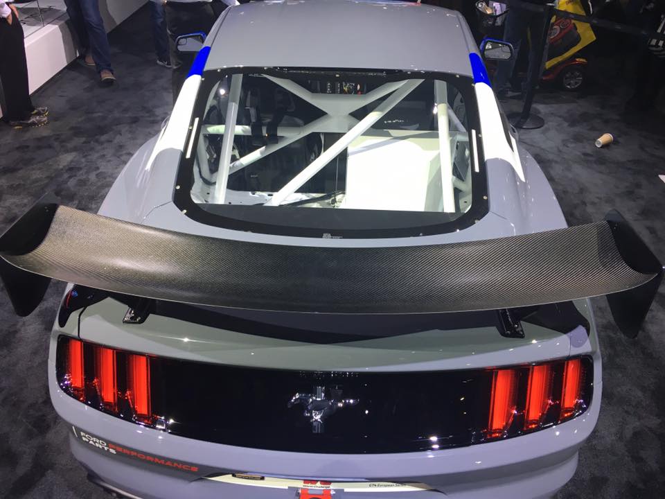

Not suspension related but have to mention the $12k hood, $3400 splitter and who knows on the wing....not for sale that I have seen.
The wing is actually the ARP GT-250. Readily available.

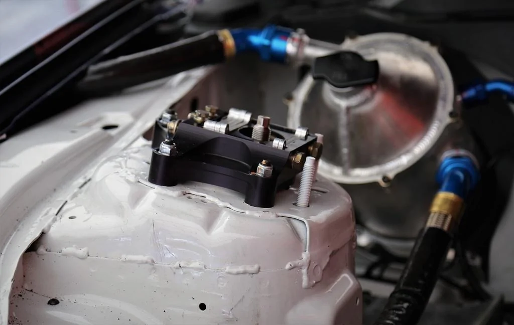

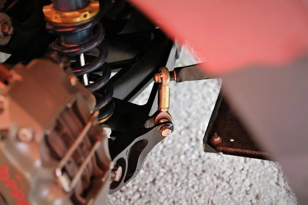

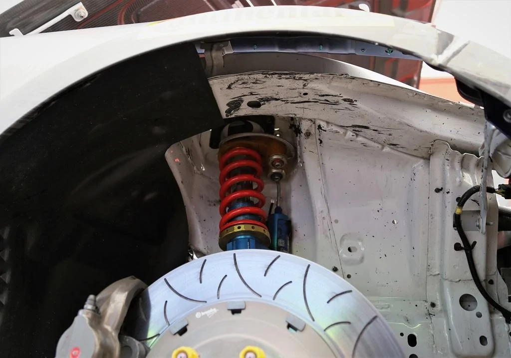

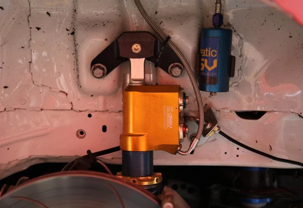

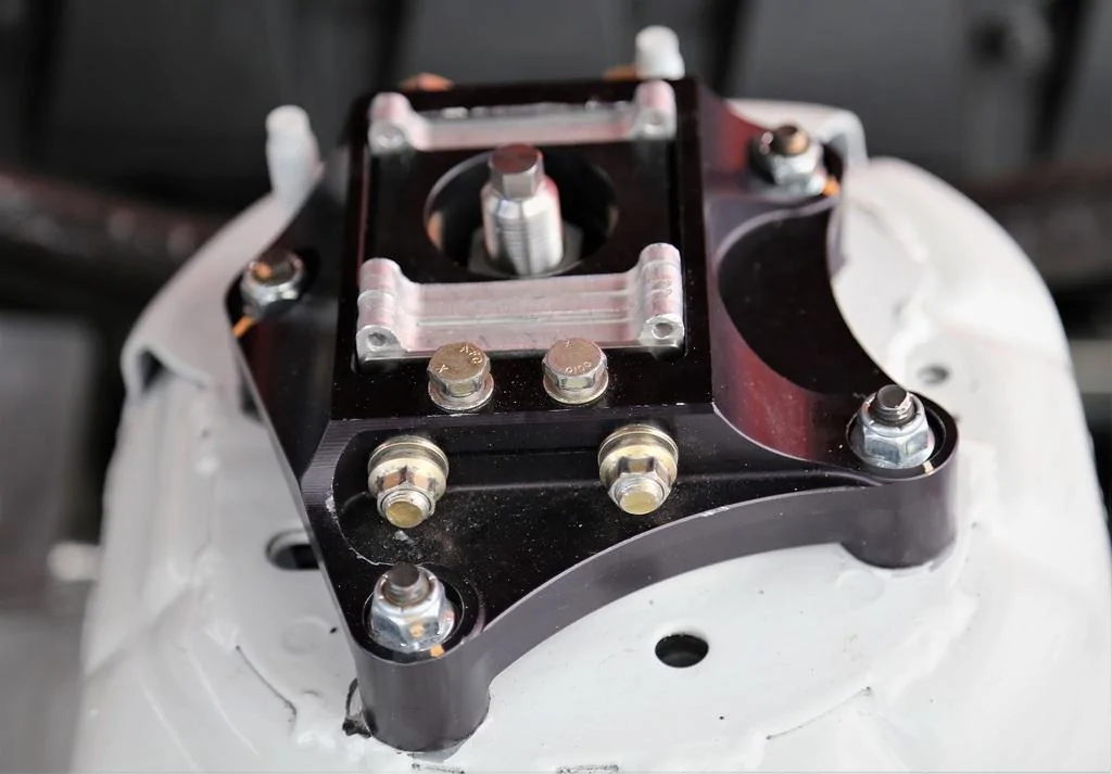

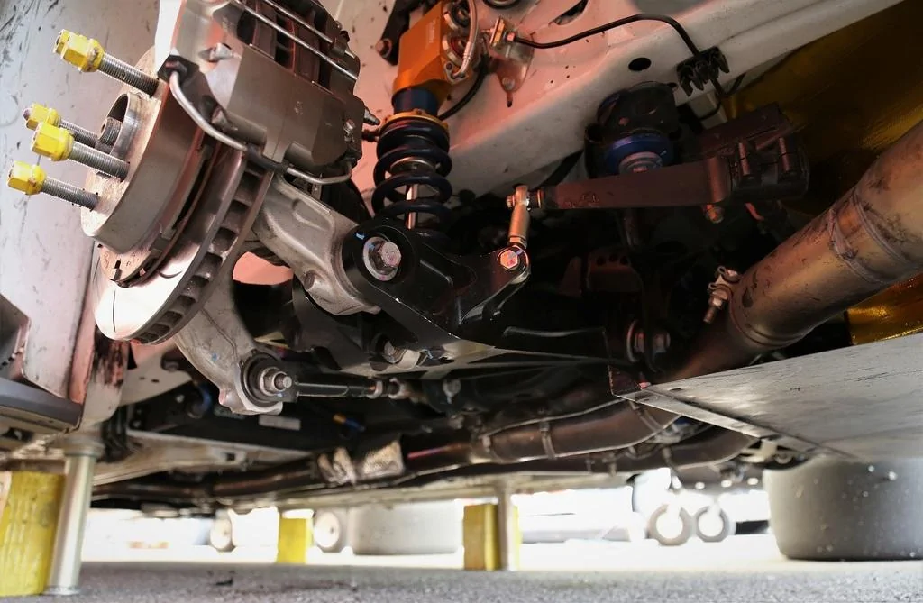

I think you can get Multimatic DSSV dampers if you buy a 1LE
Very different dampeners though....I would call the 1LE your basic DSSV dampener but not to say they are not good dampeners. Race versions such as the ones used on the GT4 or GT-C are next level. Here are some pics that Epiphany posted in another thread.
That's just plain cool! Thanks for posting.
