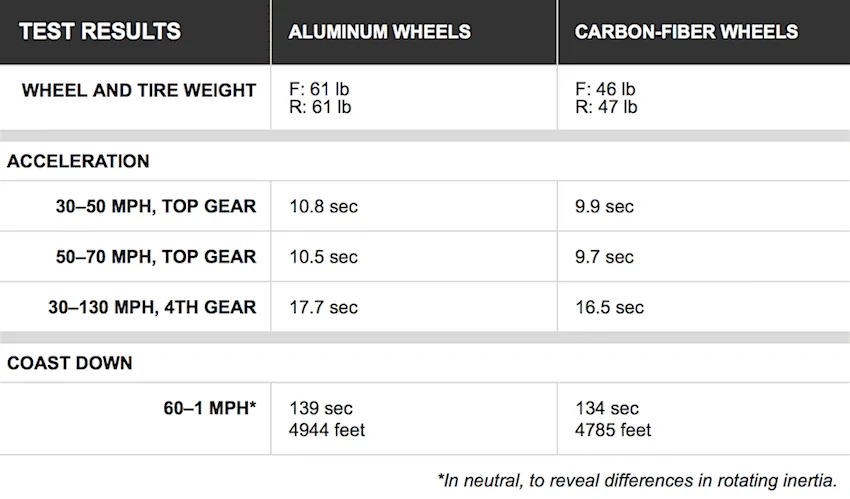

I agree that the comparison above does not correlate true scientifically reliable data, but physics is physics... Even if they sport cupped both wheels the R wheel would still outperform the aluminum wheel by the sheer physics of weight reduction period.
Yes of course, no one is arguing that. The numbers would differ greatly to those posted in the article.

So what your saying is diameter has nothing to do with acceleration. That's like saying a car with 4.10's with lighter weight wheels will accelerate as fast as a car with 4.56's with heavy wheels.

And the performance advantage is more from the tire compound and height more than it is the weight. A short, grippy light weight tire will out accelerate/decelerate a taller, less grippy heavy tire. To get the performance advantage of the carbon wheels and the carbon wheels alone tires would have to be same tire, same height.
On the contrary... This poster argued more. He says the gains in shorter tire height and compound are greater than the weight difference which is simply a false argument IMHO.
I do agree tho that a true comparison would eliminate as many variables as possible.
No. It appears everyone here agrees the shorter tire height will yield faster acceleration... But does the lighter weight of the R wheel contribute to faster times than the smallish ~1" diameter differences is the question.

Regarding the original article, IMO there are too many variables to draw a meaningful conclusion regarding performance. Clearly the lighter wheels will make a difference in performance. Clearly the gearing difference due to the tire diameter will also make a difference. Best way to know which is more significant would be to use the same size tires for the test. The "roll down" test also has differences due to aero drag and rolling resistance. Hard to know what kind of difference that made as well.
It is interesting that these seemingly small factors can have an appreciable difference in performance numbers, so I like the test from that perspective. Just wish it was a bit better controlled.
