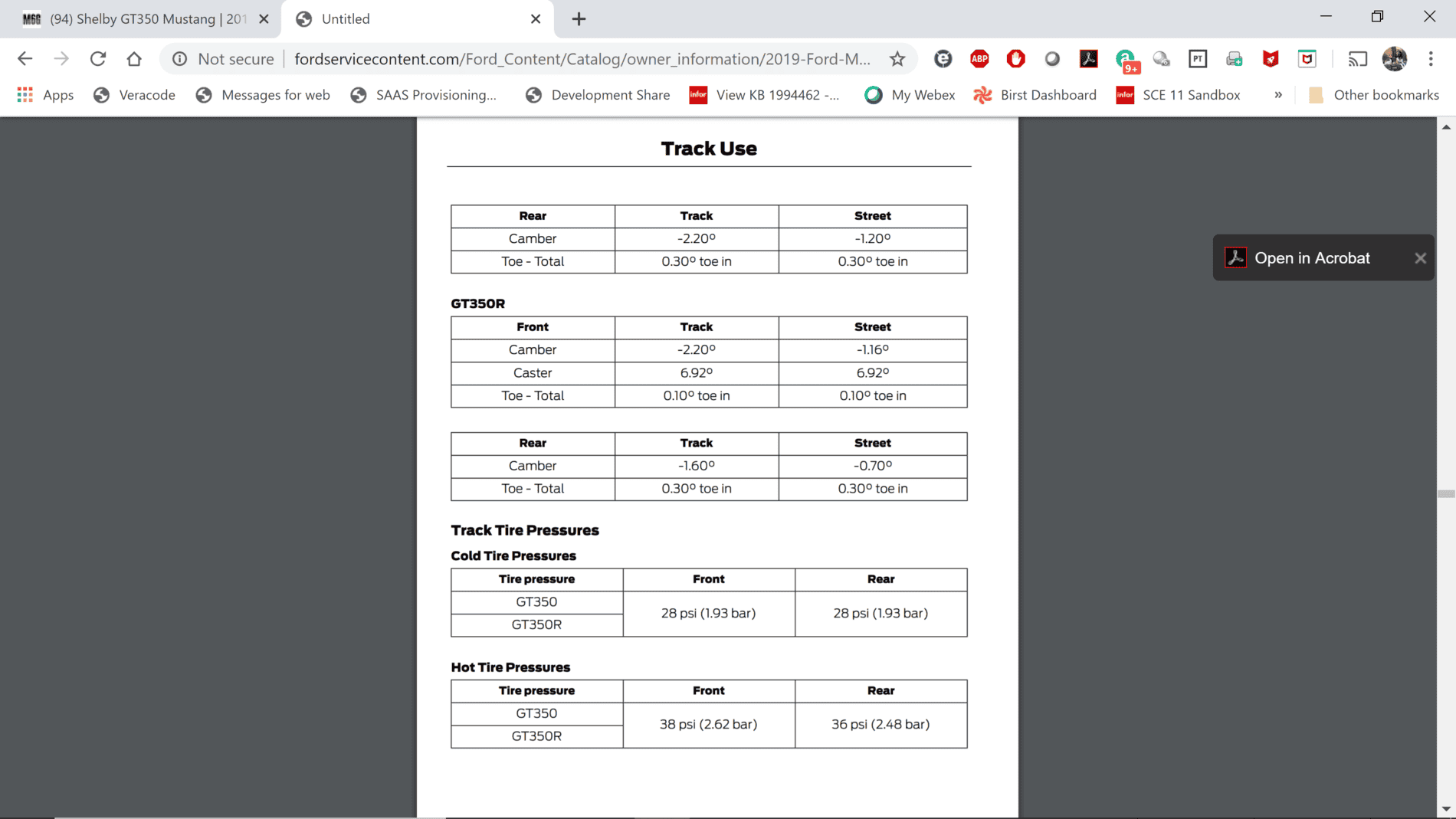

This is from the 2019 Shelby Supplement and I would assume its for a road track and with the adjustable camber plates. I think for Autocross you probably want more but you will likely have to add some adjustable plates as they only became standard with the 2019 models. Also may want to reach out to PP001 on here he is a wealth of information on these pre prod cars.

Agreed, you probably won't get that much camber out of the front unless you get plates or oval out the hole and add a service bolt, but I ran the track alignment for over a year on both autocross and track with no issues.

Thanks everyone; the 2019 has camber/ caster plates already? So I could order Fords plates and dealer install? 2.2 front or more in front?rear 1.6 ? Will the rear adjustments work without any non factory parts ? On my 2000 Cobra R I slotted the upper strut bolt holes and ended up with 2.75 degrees with no change or need for a camber caster plate? Opinions?

I thought front toe is usually slightly negative/out for track alignments. So that turn in is easier. Ford Performance specs slightly positive/in toe up front.
Anyone else think that's strange?
I'm trying -.05 on each side on Friday at Summit Point Main Circuit.
