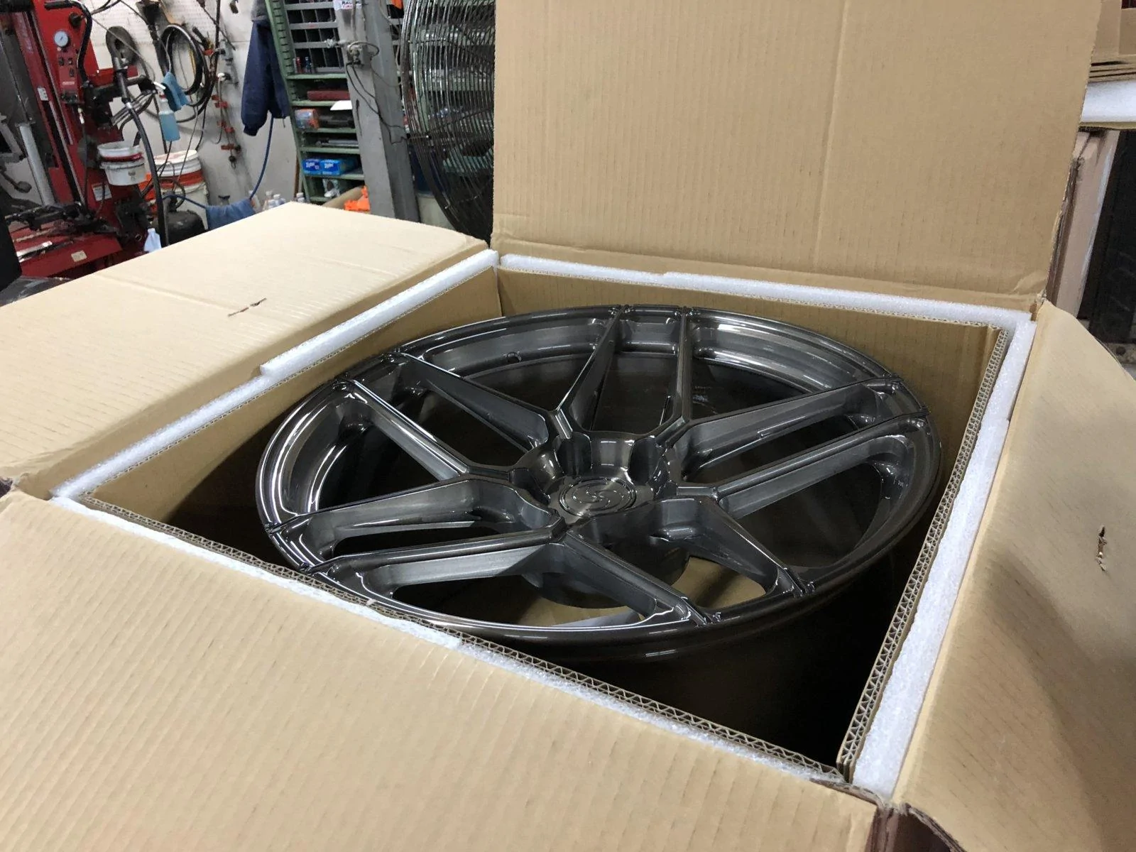

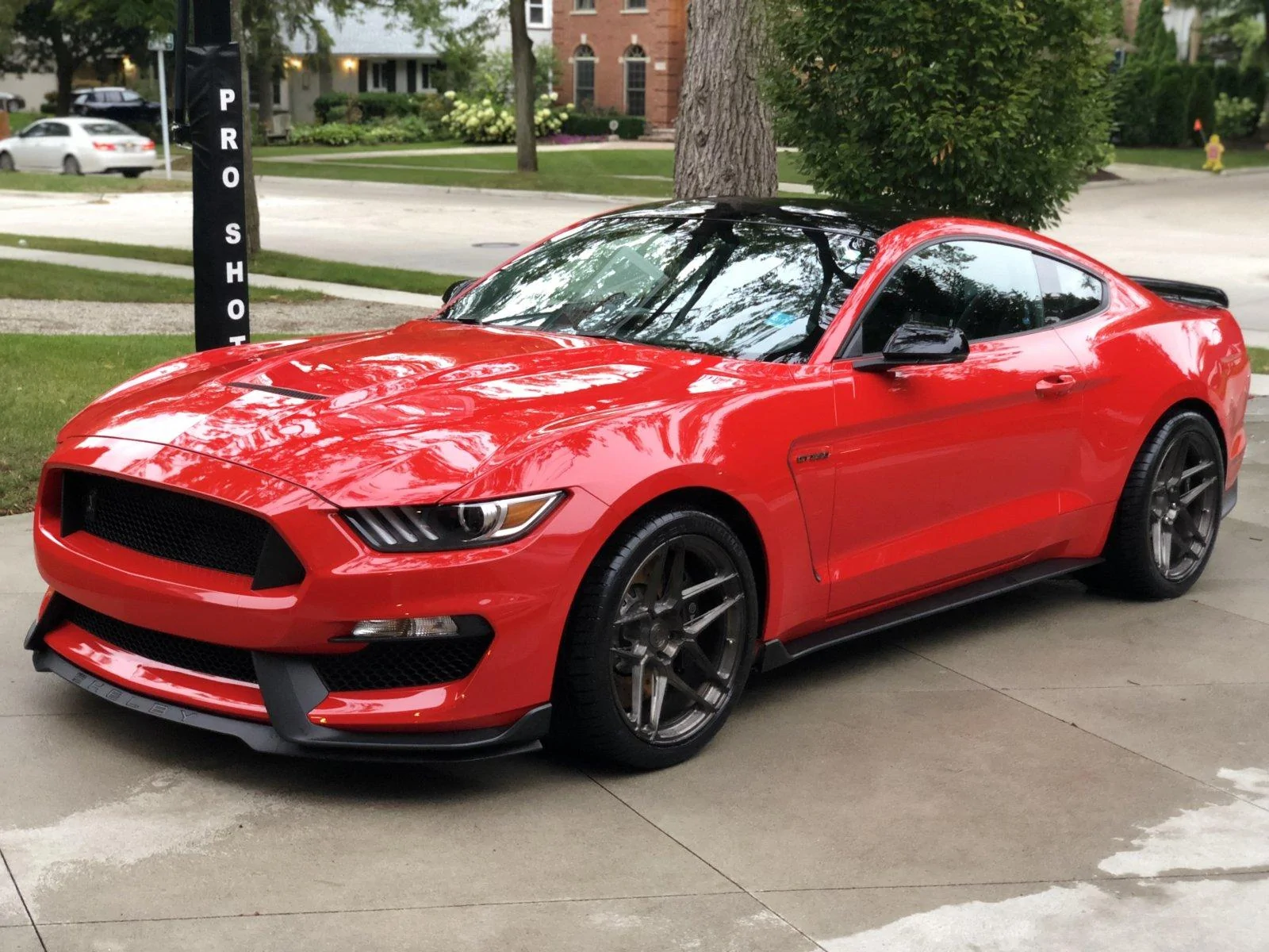

^^^ That is fascinating to me. My R tramlined a lot on the Cup tires, which are far stickier than PSS. Then I decided to save the CF wheels for track use and I put on some Signature wheels in identical sizes to the stock CF wheels, with PSS tires, and no tramlining at all (and the road noise reduction was huge, too). The car is downright relaxing on the highway now, even with zero toe and -2.5* camber up front.
