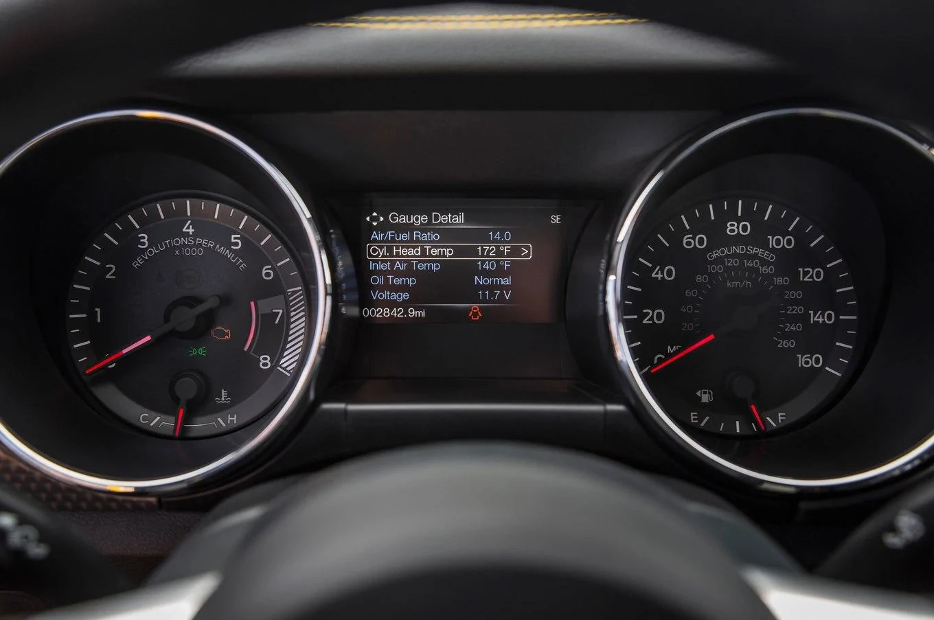

The font is different and is laid out better in my opinion. You dont have that cluster fuck of lines at 6500-8000 like on the GT cluster. And 200mph speedo FTW

Nope, font is the exact same. How many times have you gone over 160 in your GT???

Looks a little cleaner with fewer tick marks between all the numbers. That’s what made it look different to me. My gt has been over 160 several times during highway pulls. There’s a group of guys in my area that gather up Friday and Saturday and we go out to a straight stretch of interstate run our cars against each other. Im also looking to build mine to hit 200mph and would a cluster to show it. Anyway, this isn’t about why people want to do it who cares why. It’s a thread in how and it doesn’t need to be clogged up with this argument bs. If you don’t like it then you don’t have to make the swap

I want to spend the money just for the digital speedometer in the middle of the gt350 cluster. It drives me freaking nuts that we don't have one besides that stupid engineering mode.

What do you mean? This looks the exact same as the regular cluster except the higher rev and speed limits.
The ground speed text is super tacky, the redline looks bad, I just like the cleaner look of the GT350 cluster. The regular S550 cluster is just bad and my least favorite part of the car.
