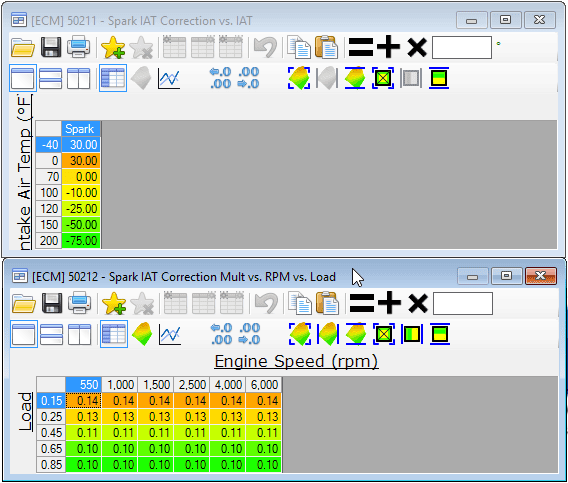

Jn2
Oct 4, 2016
233
63
Austin, Texas
Mustang GT
Sounds like your IAT modifier tables need some adjusting...I'm in Austin, only a few hours away from you and have them set up to work pretty well for the heat we tend to get during hot summers...gimme a sec and ill post a pic, you are welcome to share it with your tuner to try on yours
Edit:
This set up works really good with our weather, yes it means you will run less timing in the middle of summer when even ambient is over 100f*, but during these times you weren't going to get full timing anyway.
