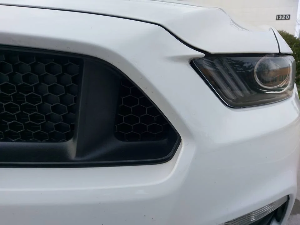

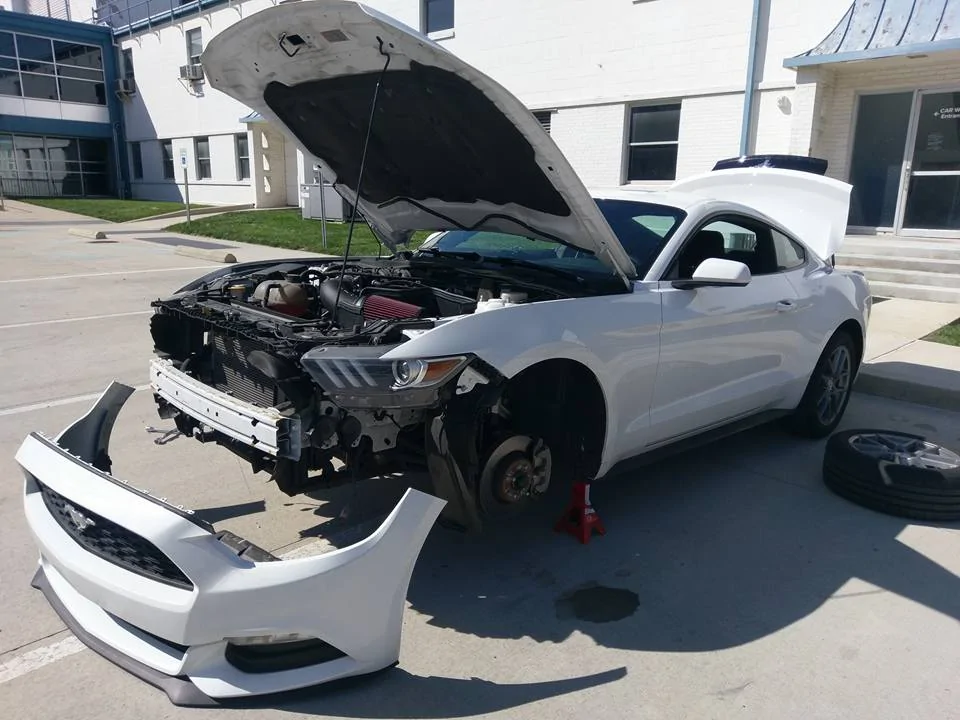

I just did it this afternoon, and with a velossatech big mouth. Opening up the GT grill for the big mouth took me one hour to get a nice clean cut. Then for the bumper removal, replacing the grill, and installing everything back took me 2.5 hours. I found a generic instruction manual for grill installation on AM, which was very helpful. The most tricky part was the two bolts behind the headlights. I highly recommend taking off the front wheels for more space. Taking off the stock grill was also quite a bit annoying. So plan sufficient time and just be patient. The actual installation time for the big mouth was literally 30s though.

Before you start, make sure how many grills you want to do. It wasn't an easy process to take off the bumper, and the plastic push rivets feel like they are supposed to be one-time usage. Those plastic rivets are easy to break when being taken off, and a few of them were not so tight as before after being installed back.
