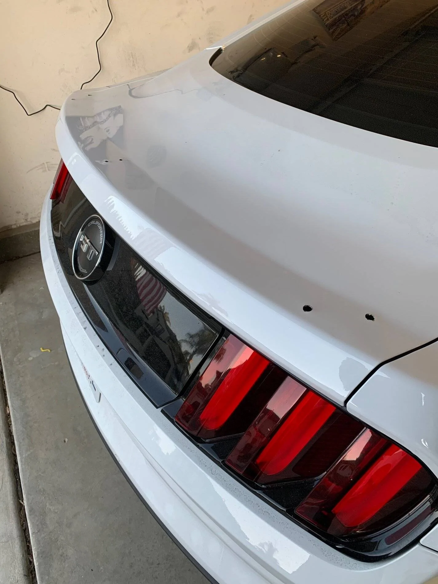

Hey, so I was wondering if I would be able to replace the California special pedestal wing with a performance pack wing or would I need a whole new trunk piece?

Here is what the holes look like. I switched to a Gt350 Track Pack spoiler and it worked great.

Thanks for the help I feel like the performance pack wing would work because it has 3 points where it attaches to the trunk. I did look at the 350 wing but I’d rather have the 350r wing I don’t think the r wing would work because it only has two points that connect.
Yeah on its face I would say the Performance pack wing should work and cover the holes. Not sure if you will have to drill new ones. But I agree. Let us know once you get it on!

Has anyone installed the performance pack wing on CS? Does it need drilling?
