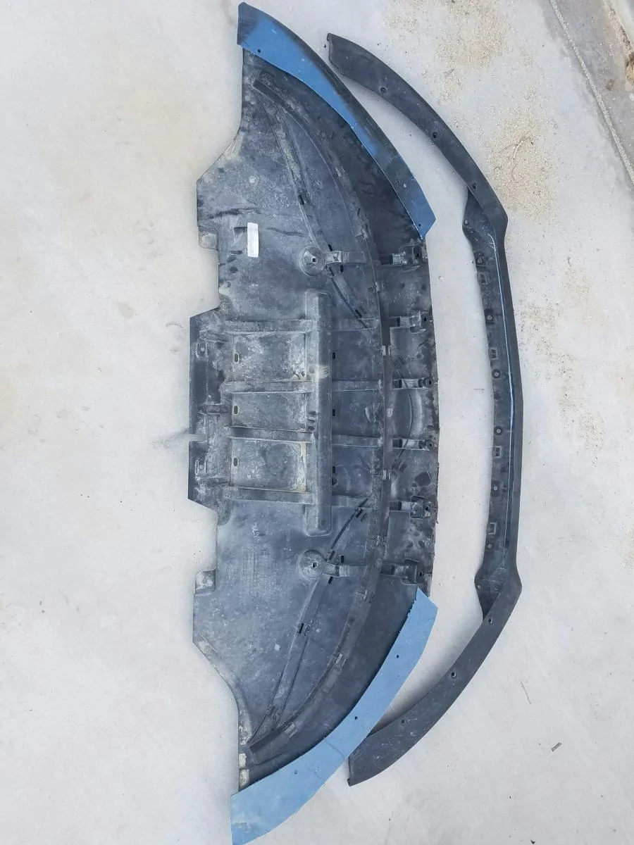

im getting ready to do this on my v6. i'll let you guys know how it turns out
You got the same bellypan as the I4? If so, let me know how you get on with doing it... I'll be doing mine on Sunday if my friend pulls through with the mounting bracket I need... ALthouh, idk why I need it and don't just mount to the bumper.

[MENTION=22912]Chef jpd[/MENTION] [MENTION=26474]Elvis66[/MENTION] Tomorrow the brace comes. My thinking is, remove belly pan and stock EB PP splitter, cut tubberware to make the bellypan fit. Make new holes, bolt it all up. then remove the brace from the splitter, put it all together and bobs ur uncle?
Any glaring mistakes I'm missing before I attempt this?!

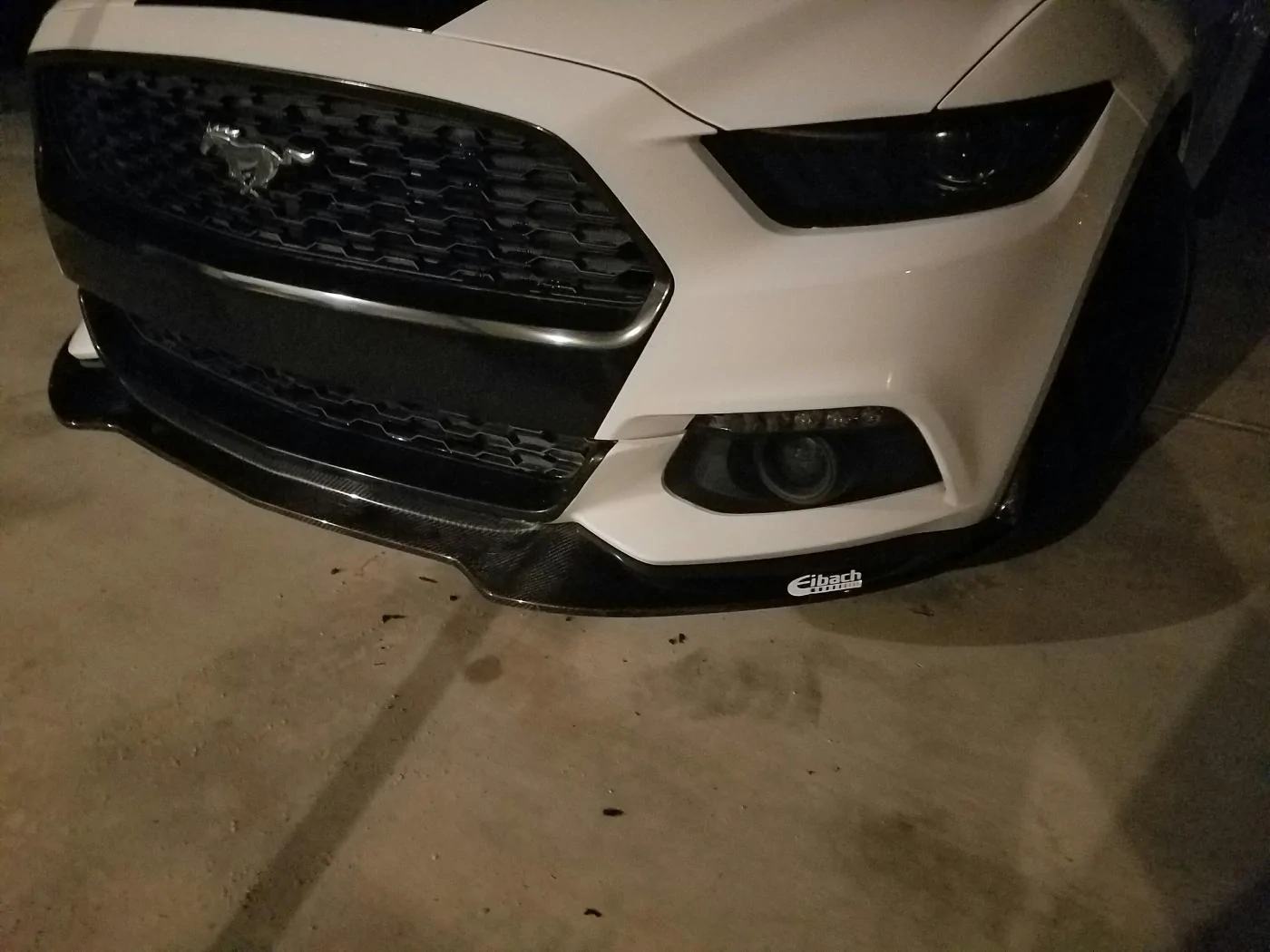

[MENTION=22912]Chef jpd[/MENTION] [MENTION=26474]Elvis66[/MENTION] fitted it on the friday, doing the extention plates wan't all that bad or hard to do they practically lock into place on the splitter drove over 200miles since fitting and all seems fine under there.
Looks effing gorgeous too as I had it painted in gloss black to match the rest of my bits.

Cheers lads, it wasn't hard, bit of a pig to align it all and get the belly pan screwed in matching the holes up as if it wasn't 100% fitted properly it wouldn't fit lol!
