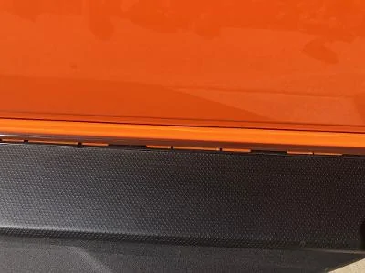

Anybody having 18" of separation from the rocker panel of the ground elects piece under the drivers door?
Possibly a warped ground effects piece?
Any solutions other than a new ground effects piece?

There was pictures of this on the first preproduction cars. So keen eyed member pointed it out.
Does it look like warping or just pulling down off the fasteners?
to me, looks like warping. panel is not loose but secure. ford bodyshop said fasteners are only good for one time as they break when removed.

thanks for info.
did the pushpins break when you took them out, if not, did you then use the original push pins to reconnect?
No they're fine as long as you're careful taking them out. I used the same ones. Probably don't want to reuse the same pins over and over 100 times but a one-time removal should be fine...
