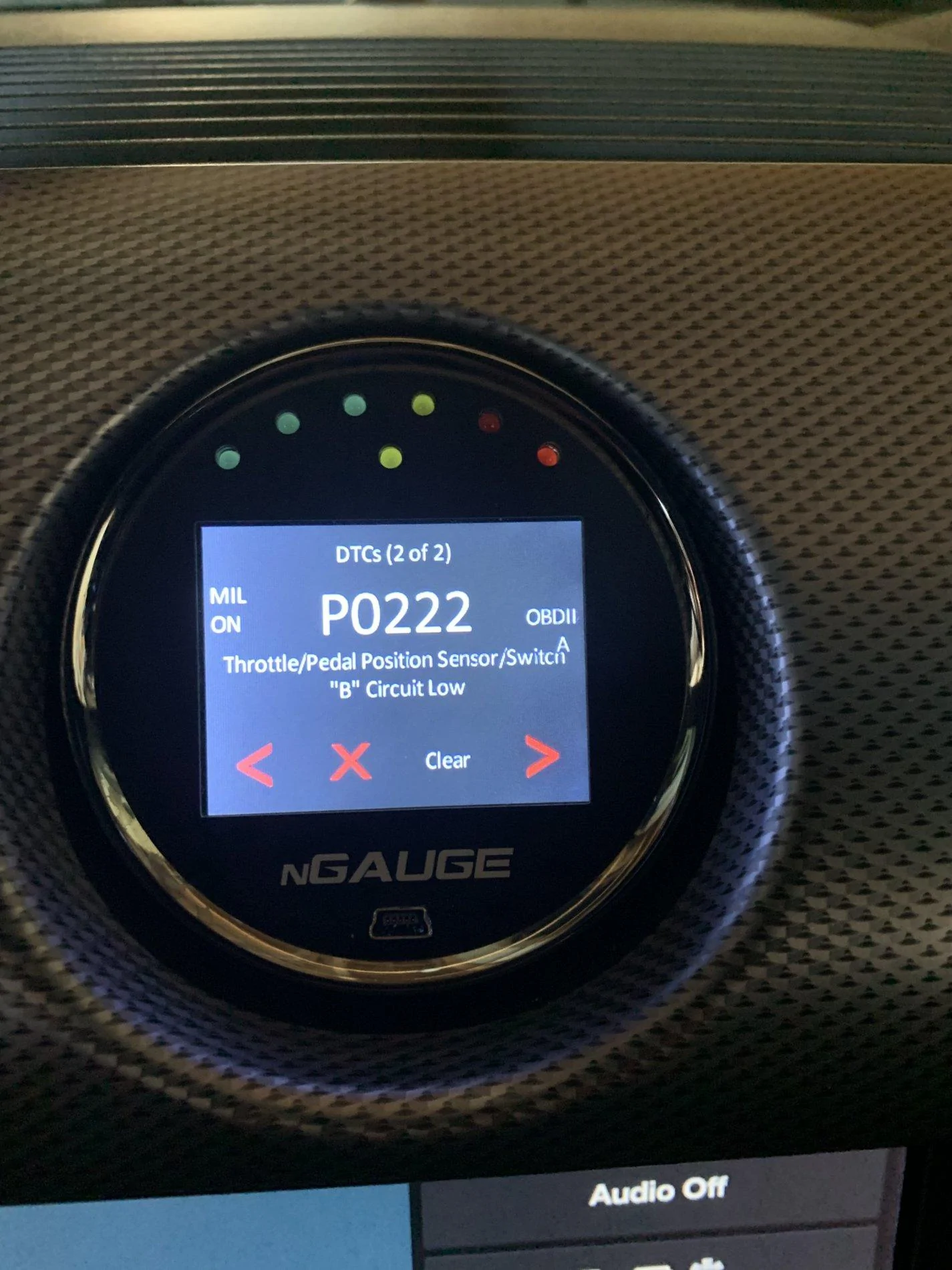

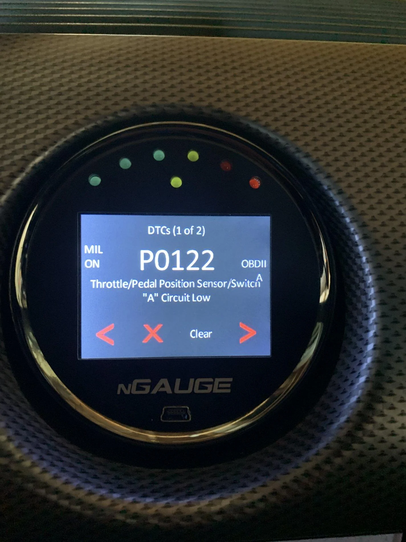

Getting throttle position sensor “A” and “B” circuit low. Causing the car to run like shit, goes into limp mode and stalls.
P0122 & P0222 pulled from the nGuage.

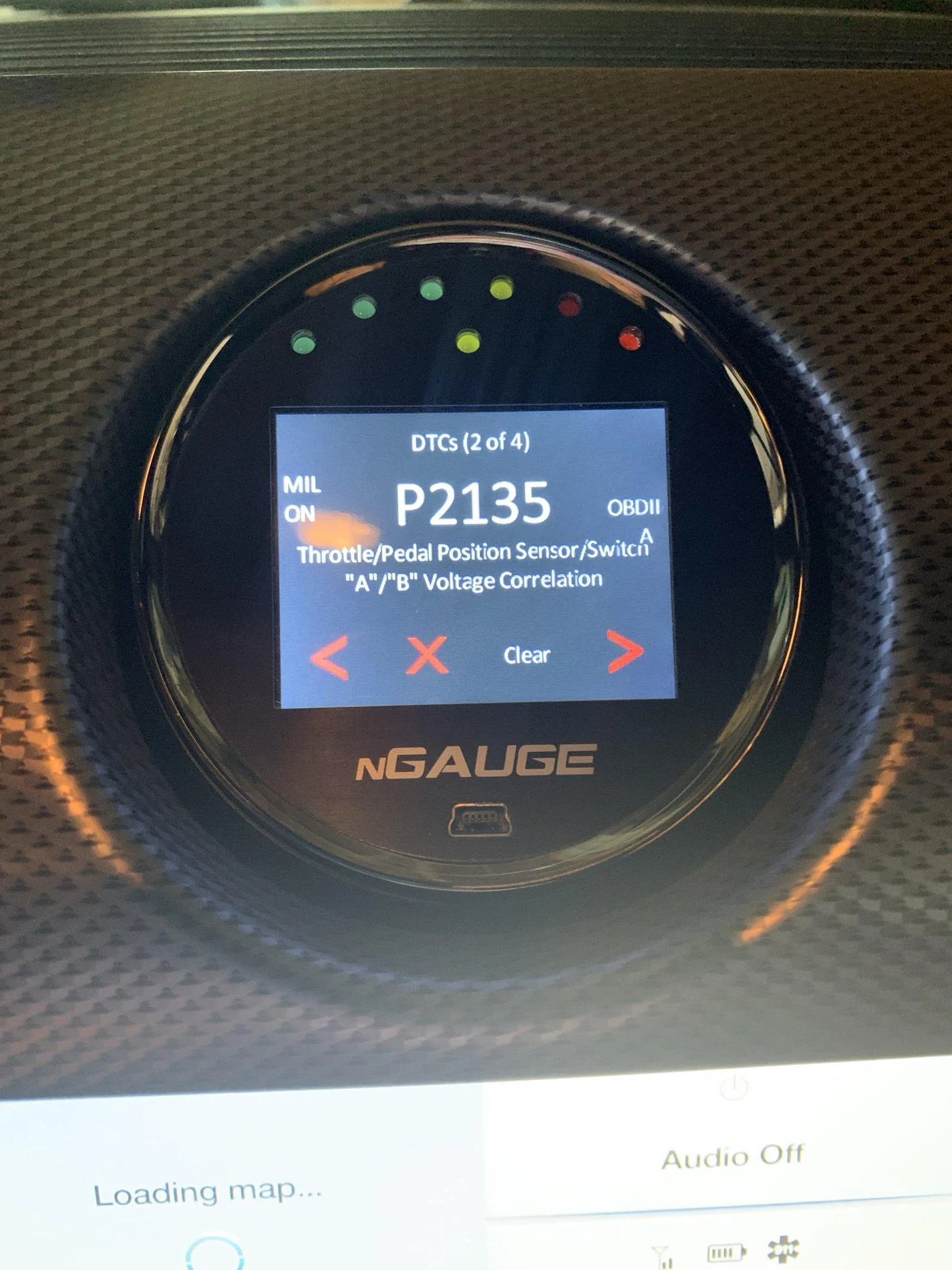

Ok so I’ve unhooked all the BAP wiring and still running like shit. This is concerning... maybe a bad pedal???
Any help would be appreciated, not sure how to test that without buying a new one.
Here is the latest code.
