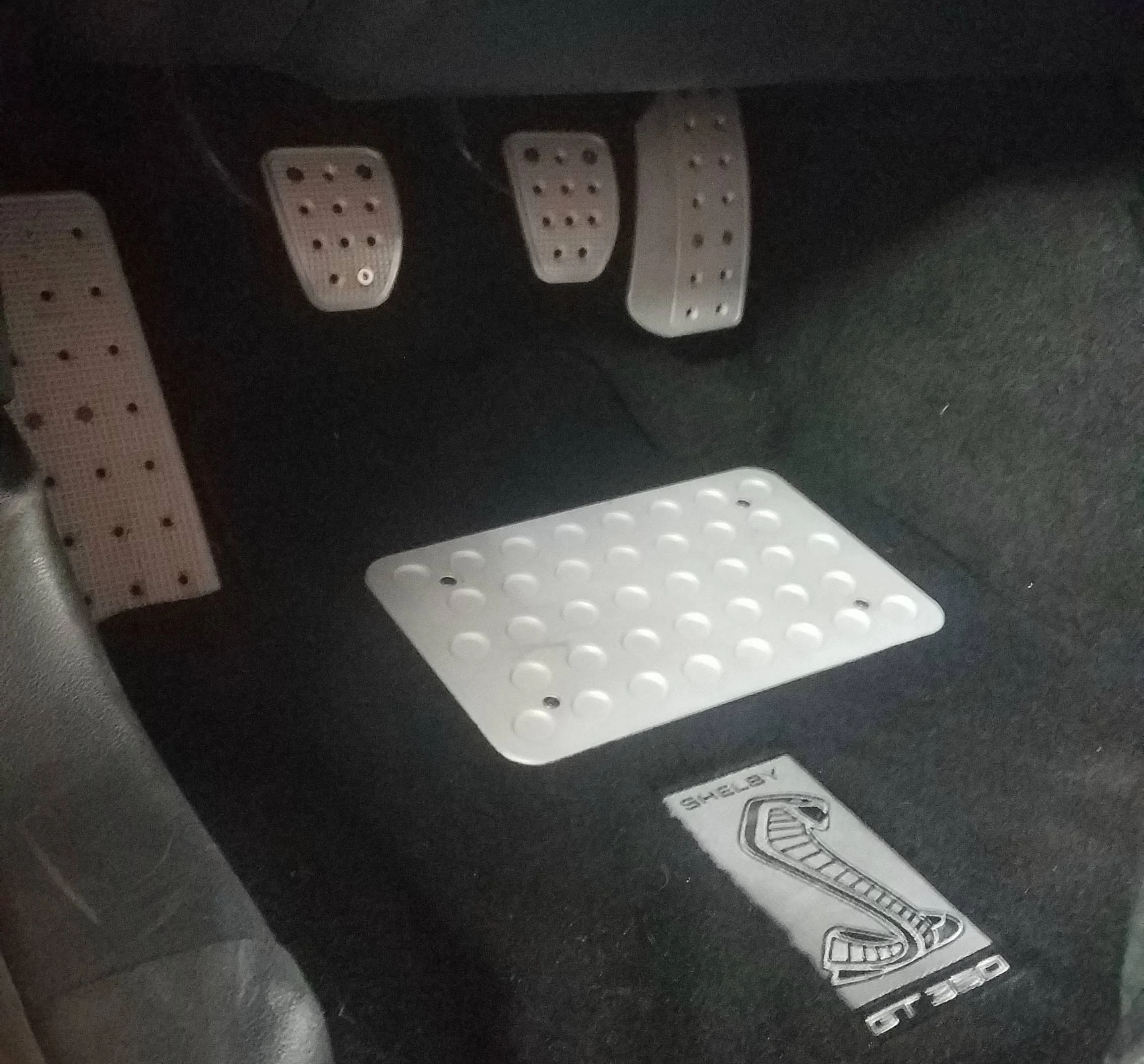

Literally three 10mm nuts and an electrical connector. I marked the location for drilling for my pedals with it in the car and made sure I didn't have issues getting to WOT, then removed and drilled.
Looks fabulous!!!!!!!! Love it!!! =) Thats smart, im gonna do the same. Plus make sure that its super straight as well. I had a foxbody and the damn pedal covers were crooked lol i always hated looking at them, but was a major ballbuster to install in that car.. Dont wanna make same mistake again! hahahaha Hence the pedal removal.

Best of luck. Drilled the gas pedal and dead pedal with a regular drill bit out of the car after marking location inside of the car.
On the Brake and Clutch, you kind of have to do it in the car and I used a dremel ball bit to make the holes as it is way easier to get into such a tight space and you don't have to be perpendicular to the pedal since you're grinding the metal out with the ball bit vs drilling.
