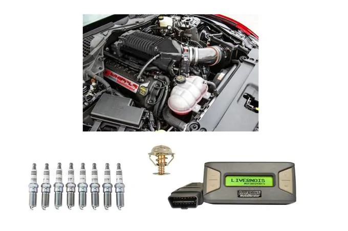

Yes i 100% get what you are saying and agree. However if people want to turn up that kit Livernois does offer a package that includes a BAP and injectors is all i was getting at.
Would you run a supercharger kit on factory injectors? They are the only performance shop that offers a supercharger kit that utilizes the factory injectors.
Like i said we have the kit that gives you the most power on factory injectors and then we step it up with our next package when it is actually neccessary to change them :thumbsup:
