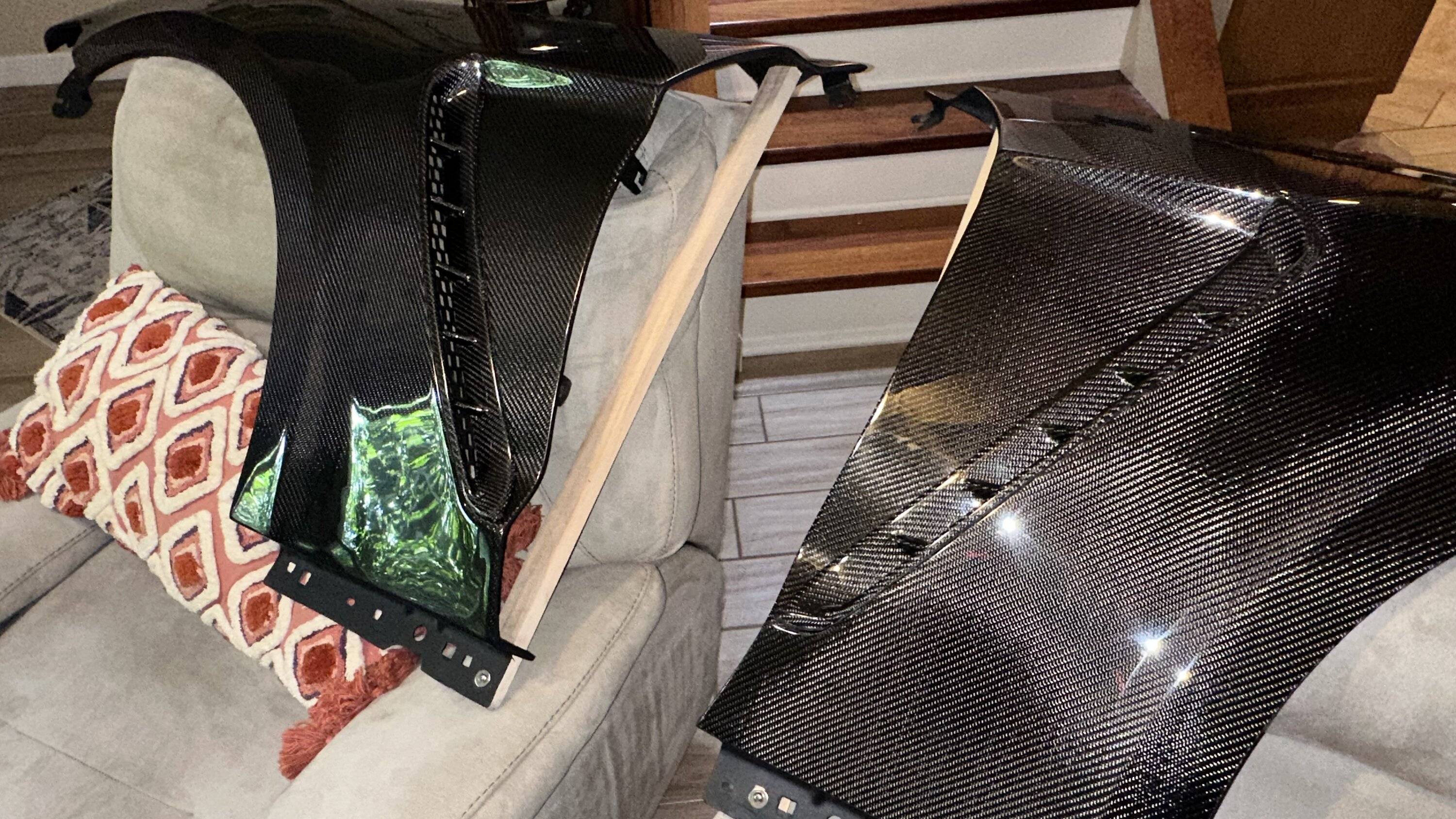

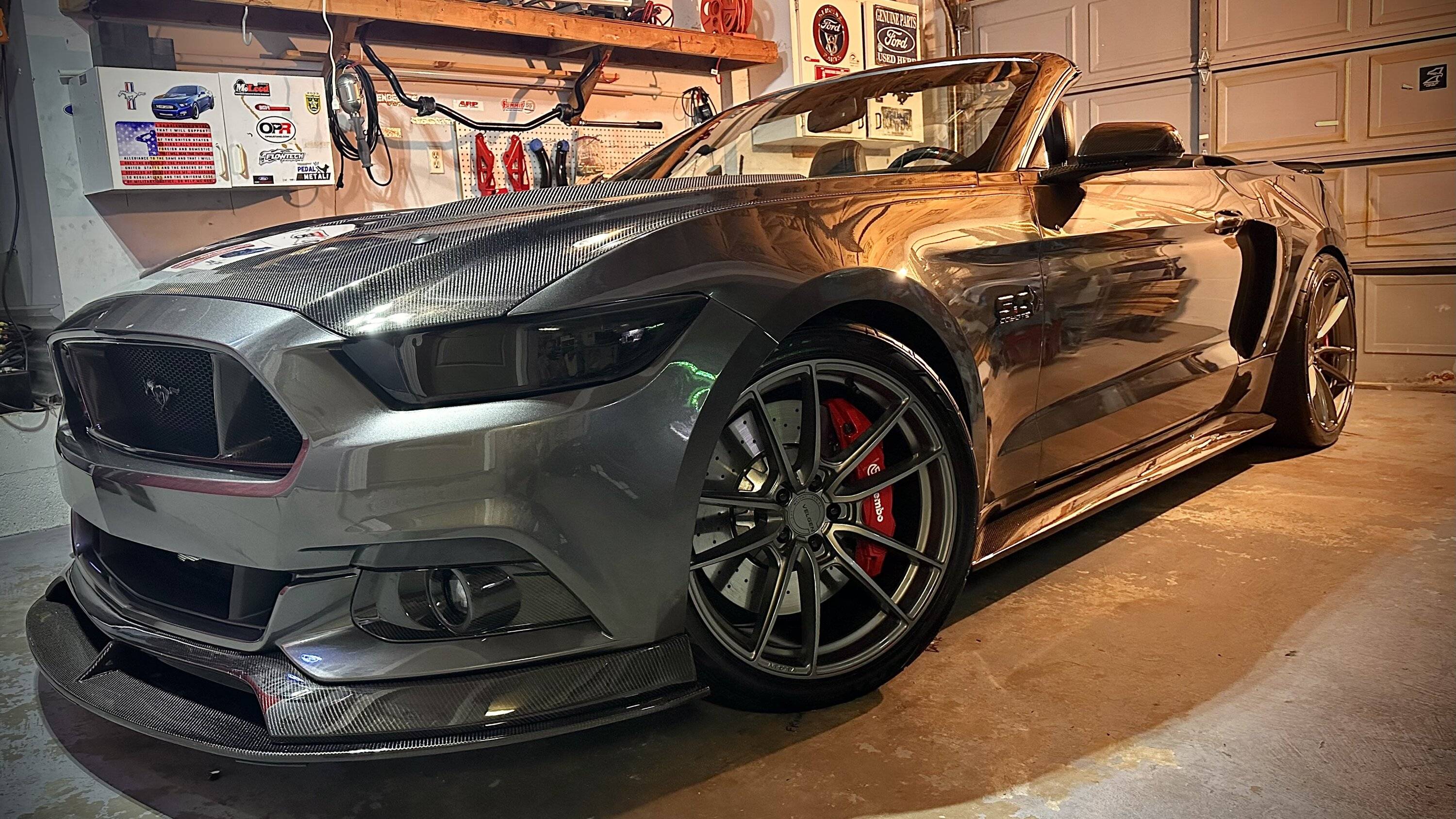

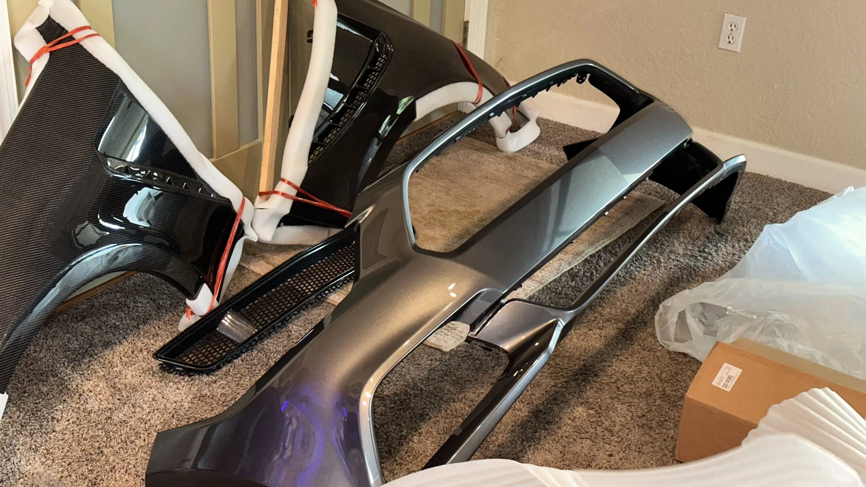

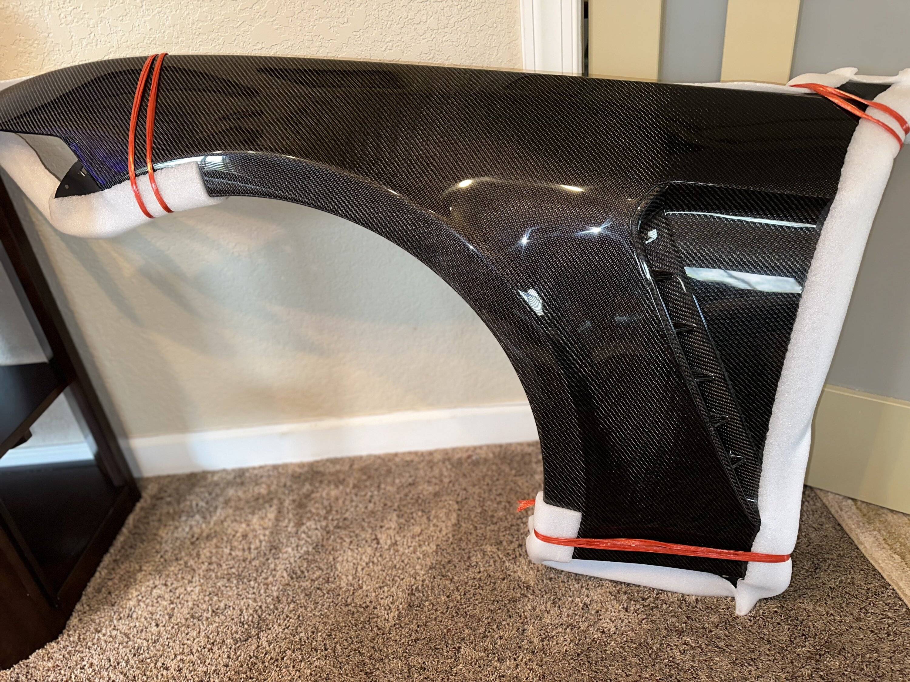

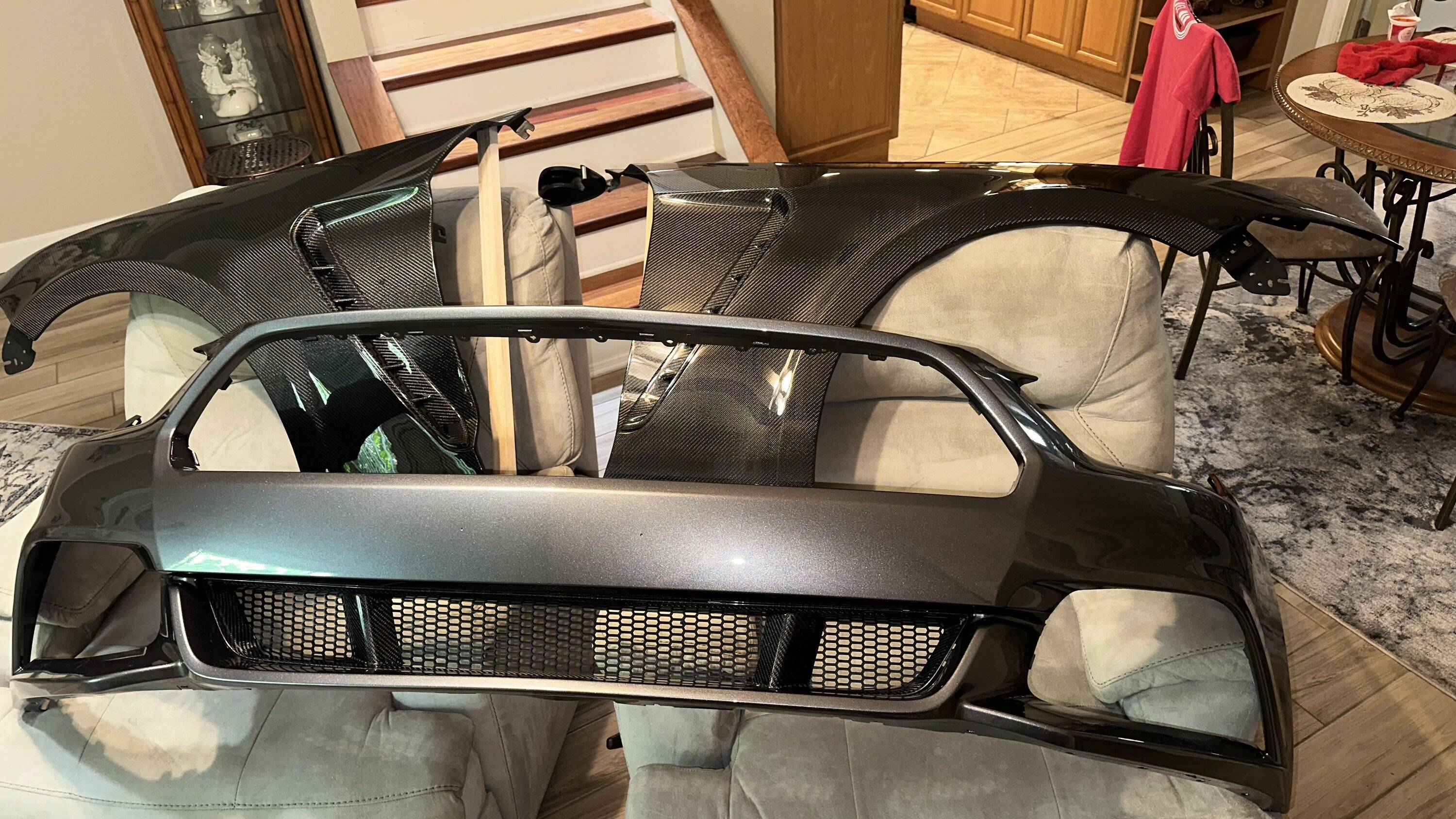

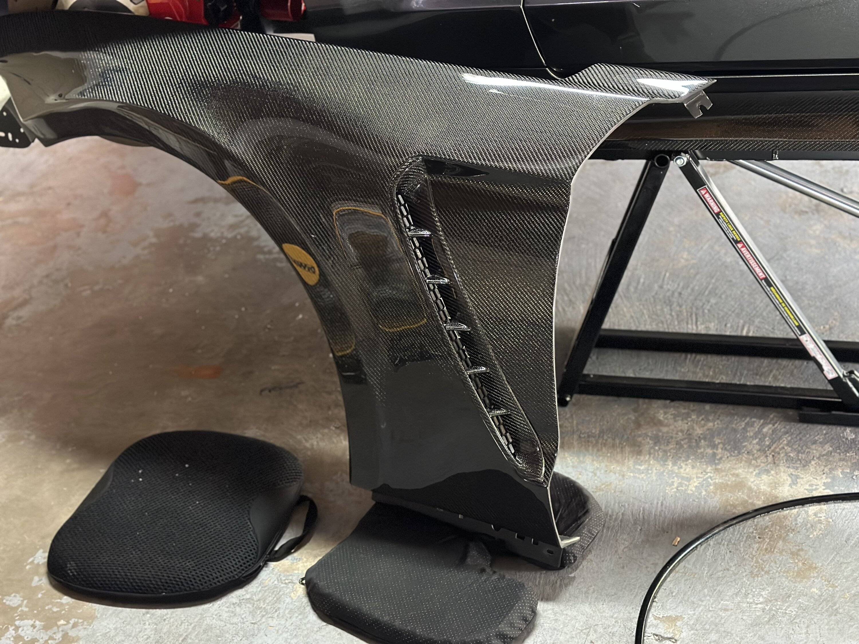

Got my Type-GR GT350 fenders and lower grill today.Also got a new oem painted bumper.I have everything Anderson composites makes in carbon fiber for the 2015 GT.I definetly went all out with this build it took me a year to complete.

I am really interested in the fenders, I plan to get them next year... do you have to have them sprayed with clear coat?
Carbon Vacuum Infusion Process (VIP)
Anderson Composites VIP carbon fiber parts are manufactured by spraying a coat of resin on the mold, sheets of carbon fiber fabric are laid out across the mold and then a final coat of resin is applied on the fabric before being placed inside a vacuum sealed bag to cure (provides an excellent fabric-to-resin ratio). Once cured, the part is removed from the mold, trimmed and a final coat of gel coat applied and polished to protect the surface and increase the high luster finish. No additional clear coat is required.

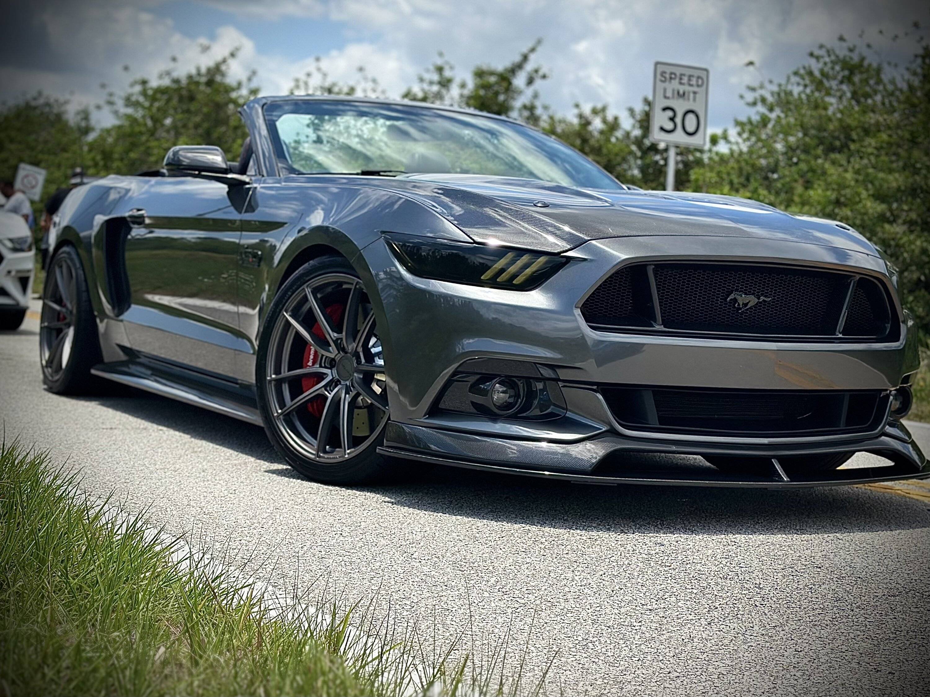

Stang looks great man, one of the better convertibles I've seen. Do the GT350 fenders actually add any width?
