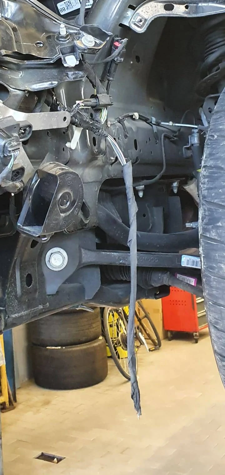

I have been in an accident, and my front lights got destroyed. (Headlights & fog turn signals)
It was picked up by a tow driver and held in storage for 1 day.
A day later, the car came in the garage but with the wiring cut.
I really need your assistance, I couldn't find the wires anywhere, or any explanation about it.. nada.
Please see how it's suppose to be.
Driver side:
You can see the same long wire splits to 2 connectors: Headlight, and turn signal.

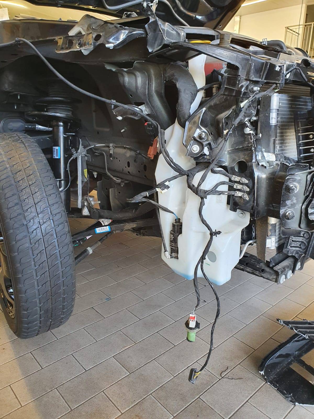

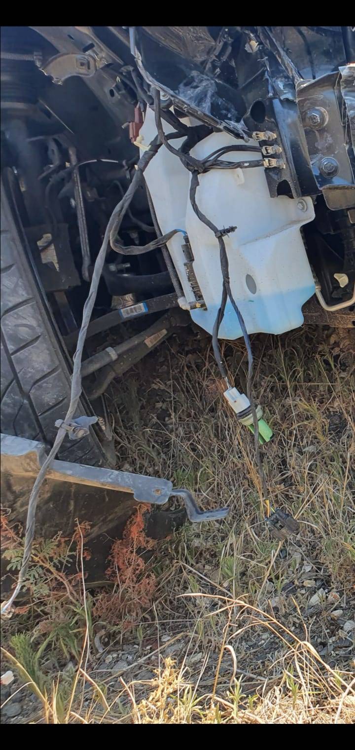

This is current state:

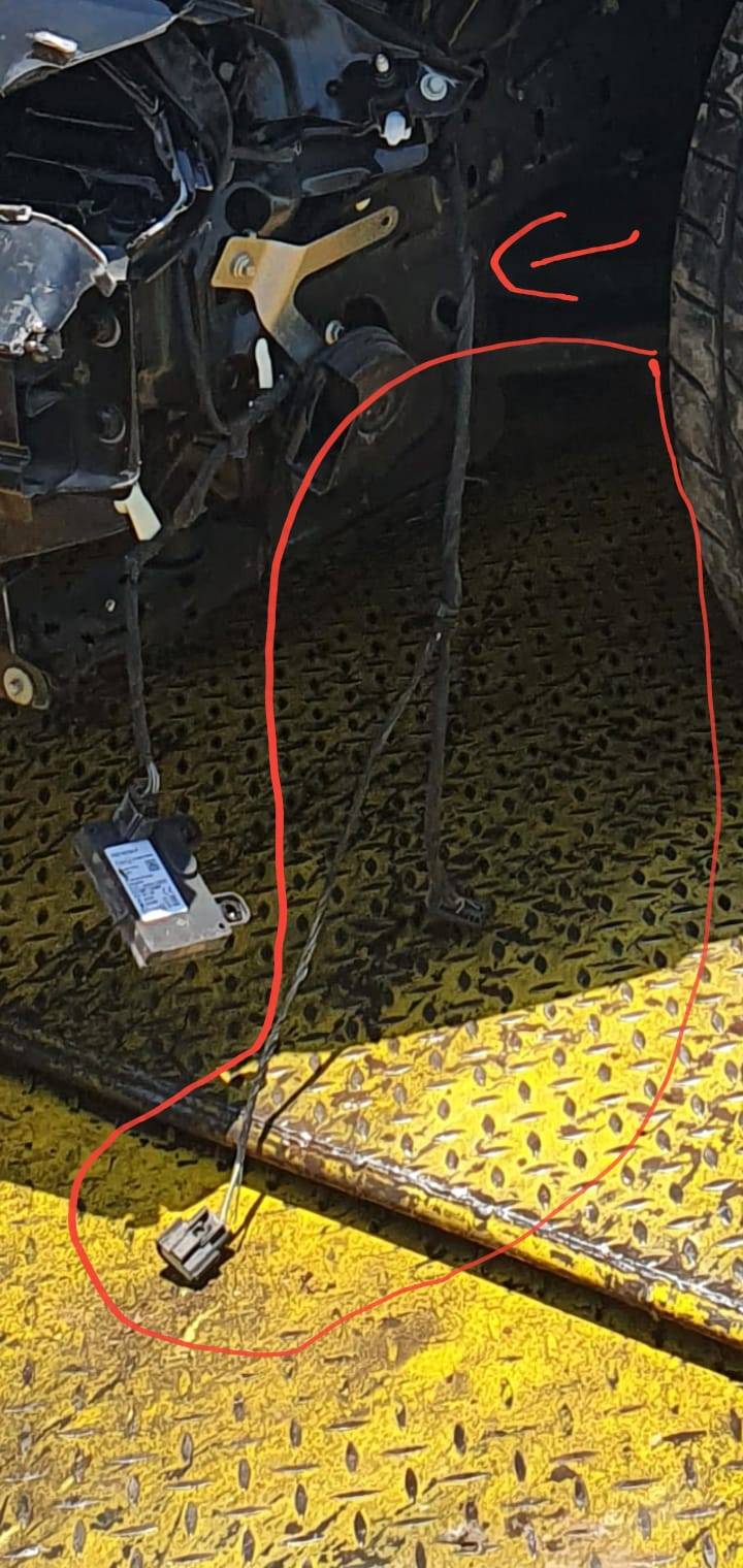

And, in the Passenger side, only the Headlight wire "disappeared":
This is after accident:
This is in the garage, where the main wire is not there:
Will appreciate your help SO MUCH!!
I have no idea what to do.. and the garage guys don't have any idea how to fix this...
Where can I find the right connectors?
Wiring? Anything..

It's not the wiring diagram I need, but the actual wiring harness/connectors so I can fix this / replace the whole harness.
I just can't find nor the correct wiring harness or the actual connectors...
