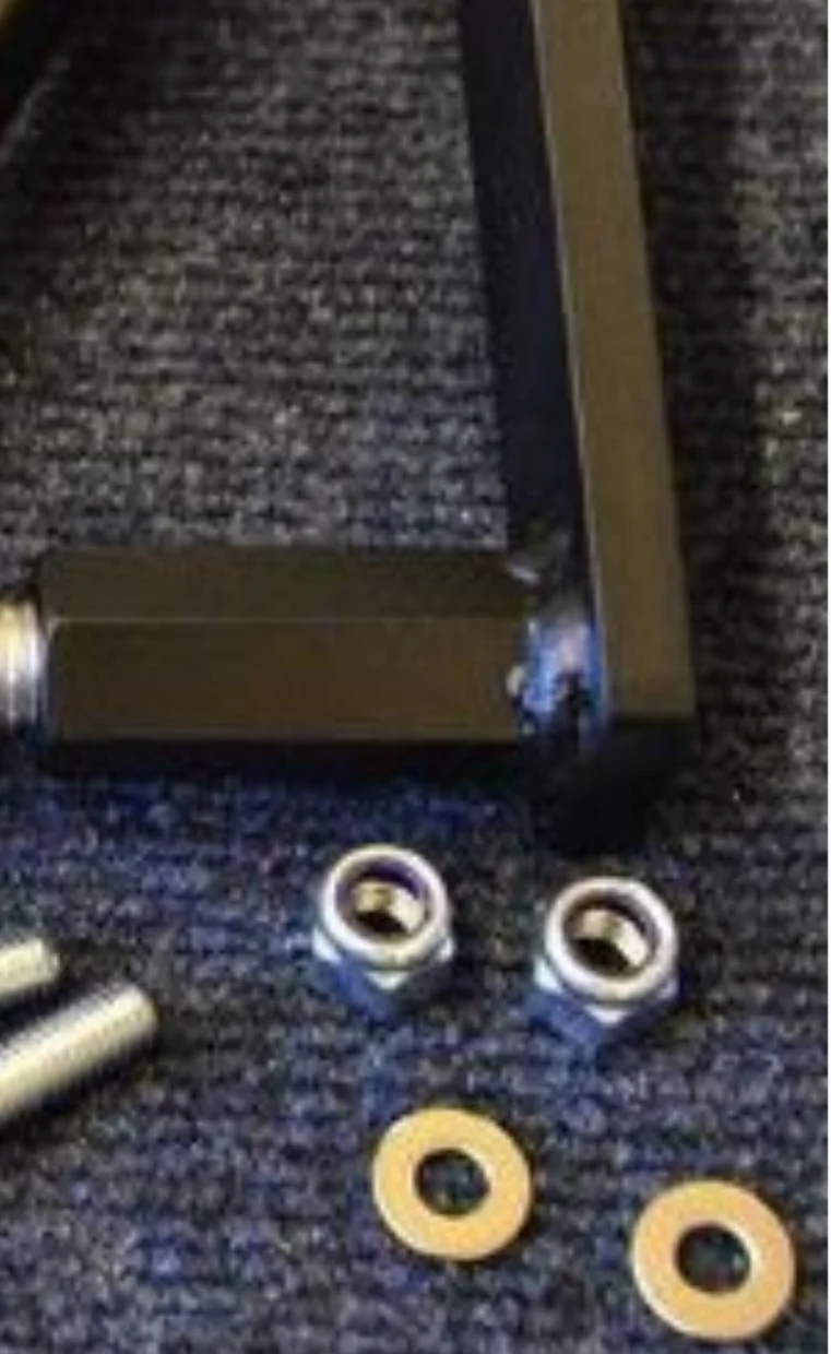

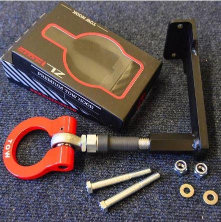

You can move it up but won't be OEM. It will definitely be placed a little under OEM. If the oem look is what you are going for, have you considered putting 3M tape on it? That's how I've had it for my previous vehicle and never had an issue with the plate falling off.
From the picture it looks like the bracket is oriented with the long arms down and the short arms up. Could you mount it the other way around, with the long arms up? That would still be lower than OEM, but wouldn't be right in the middle of the lower grill. It's either that or I'm going to manufacture my own.
