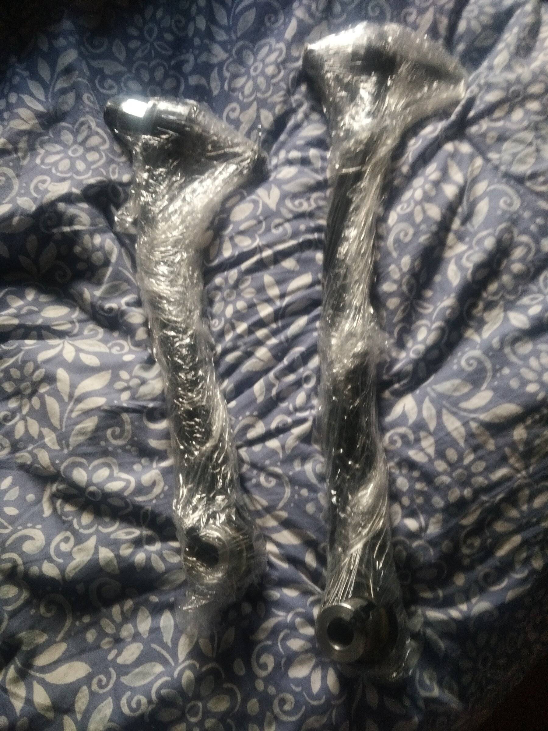

I have been eye balling Maier tubular spherical control arms.

'Upper' arm?
Bahndvr
Bahndvr
Roushcharged
Jul 4, 2014
185
1,504
220
Germany
'16 Roush Warrior Mustang
'Upper' arm?
My left lower failed
I had forgot I bought the Maier front control arms kit (upper & lower)
