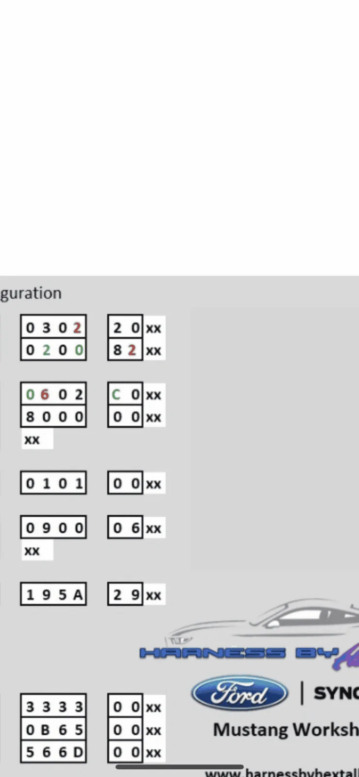

I need some help with FORScan. There are numbers and letters were the X’s show so do I remove them or leave them alone? This is for the configuration and programming for FORScan.

Sadly there isn't a Standard, but from what I've seen
The small x's (in the actual address location), you usually always leave alone.
On some illustrations you may see a large X, or a '?' along with small x's.
What this means is you ONLY change where the large X, or '?' is, and ignore the small x's.
In your illustration above, it kind of looks like they have all digits shown in the actual address location, and beside/underneath they use x's to denote what changes or needs to be changed. Also, they are using Red and Green colors to indicate something.
Another note: The 2 digits at the end of the string, are Checksum digits,
If you make a change to any of the first digits, the last 2 (Checksum digits will always change)

Thanks for your feedback bro. I figured it out
