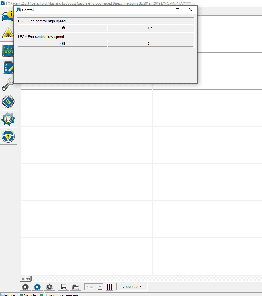

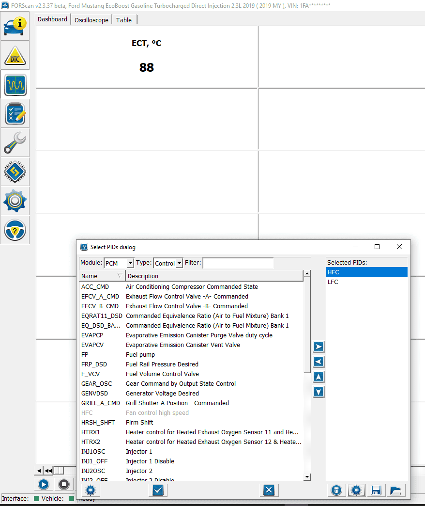

I did some digging around on youtube since i didn't see anything on the forums about this. i was interested in manual control of the cooling fans mainly to try and cool the car off quick between track sessions. I was able to trigger the high speed fan with on/off, i wasn't able to find any kind of % fan speed control. I am not exactly how effective this works with the thermostat functioning. Any one else have any useful control outputs? You can also set the speedo to 100% if you want to play a joke with your friends.

Are you able to use ForScan to have the fan turn on sooner for aftermarket thermostat?
I'm trying to save a trip to my tuner to do that.

no, this is just a manual control that only works when forsan is running.
