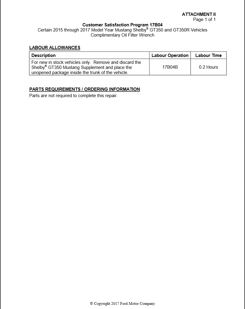

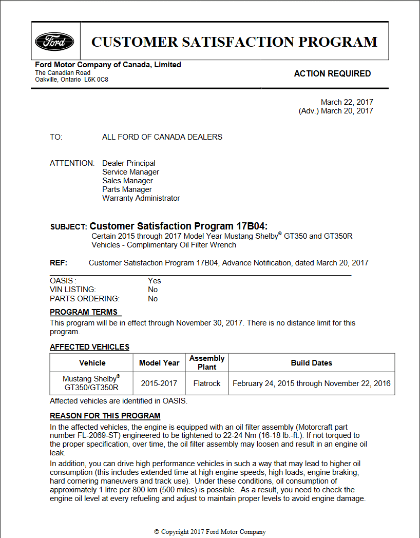

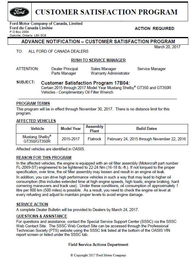

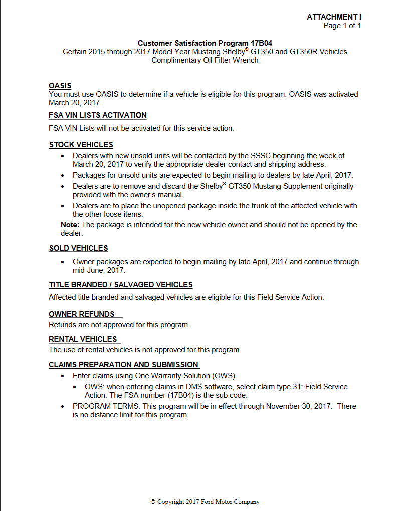

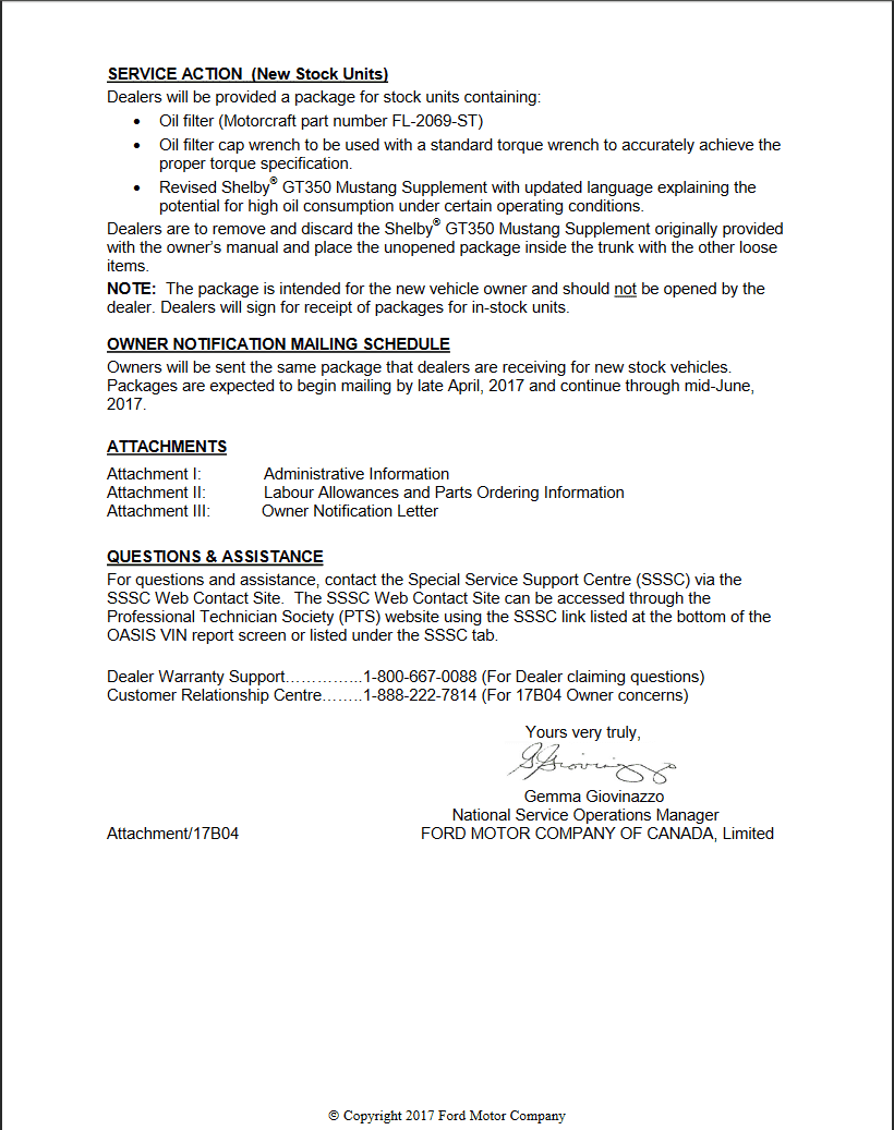

PROGRAM TERMS
This program will be in effect through November 30, 2017. There is no distance limit for this program.
REASON FOR THIS PROGRAM
In the affected vehicles, the engine is equipped with an oil filter assembly (Motorcraft part number FL-2069-ST) engineered to be tightened to 22-24 Nm (16-18 lb.-ft.). If not torqued to the proper specification, over time, the oil filter assembly may loosen and result in an engine oil leak.
In addition, you can drive high performance vehicles in such a way that may lead to higher oil consumption (this includes extended time at high engine speeds, high loads, engine braking, hard cornering maneuvers and track use). Under these conditions, oil consumption of approximately 1 litre per 800 km (500 miles) is possible. As a result, you need to check the engine oil level at every refueling and adjust to maintain proper levels to avoid engine damage.
