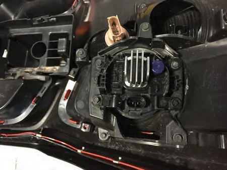

Oh man, I just had my front end off this morning. Would have taken a shot of the connector if I had seen this post.
But, it's quite easy to get a look, turn the wheel all the way in board, 3 push pins and pull back the fender liner, there she is..........
Here is a pic of the fog light for your info......it's the 2 pins under the heat sink.

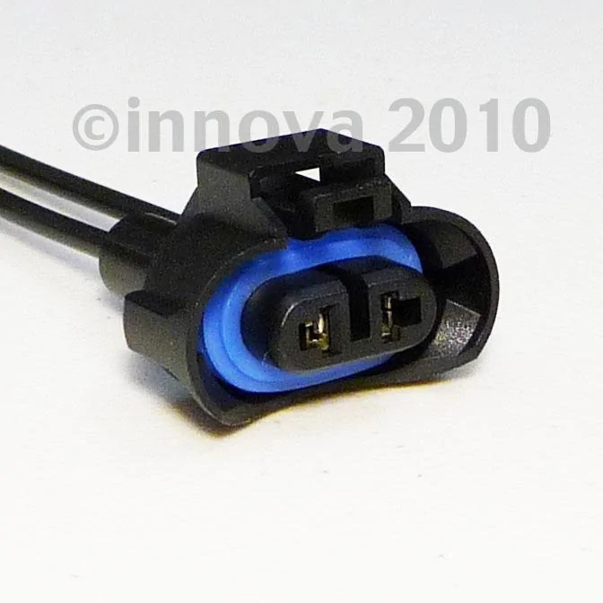

It looked more like this h11
Single lock, 2pin
Single lock, 2pin
That looks to be correct. Thanks! Now I need to find a pigtail that the car harness will plug into.
