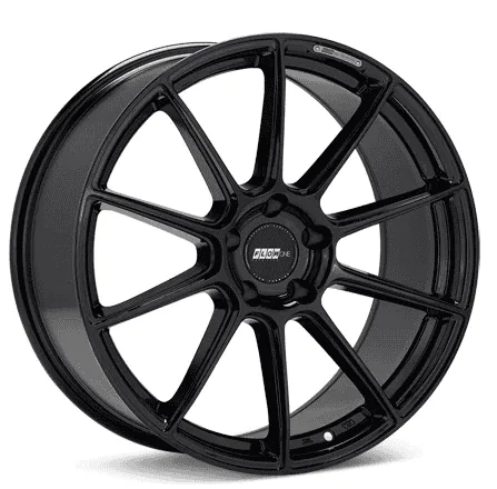

Does anyone have any experience with Flow One wheels found on Tire Rack? I am looking to run an affordable, square setup with a little taller sidewall than my current setup. Current setup is an SVE S350 in 20x10 with a 275/35R20 tire. The Flow One F3 is a 9.5X18 wheel with a 38 offset and i would like to run a 275/40/18 tire with this setup.
Could this wheel be used as a square setup on a 2015 non-pp car? Any foreseeable issues with the offset?

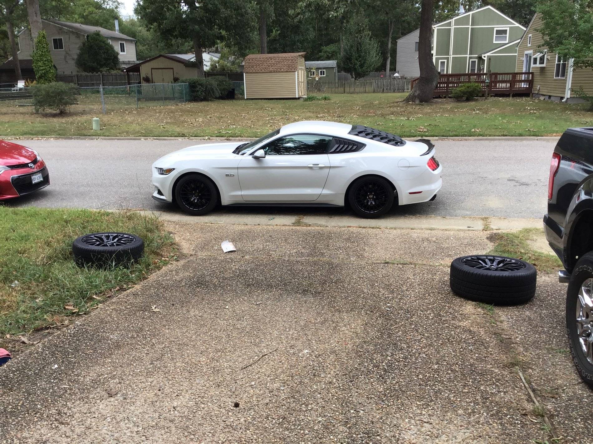

Yes, you may or may not need to run a spacer up front to clear the strut, I’m not sure though when I tested those I had coilovers on the car already. Nice thing about TireRack and their partners is they’ll let you order a wheel to test fit on your car in their shops to be sure. Those flow ones should be going on sale soon, last time they priced out @ $189 ea. Your none pp car can also wear 17’s front and rear.
The pic is of my 17 GT PP with 18 x 10 OE Racing wheels and 275/40/18 NT05’s on all 4 corners.

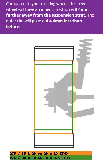

Going from a 20" wheel with 40mm offset to a 9.5" wheel with 38mm offset will recess the wheel by 4mm and provide 8mm additional inner clearance. I also have the S350 wheels in 20x10 with 275/35-20 tires. The ride is harsher than I prefer. I've been shopping for 19x9.5 wheels and intend to use 275/40-19 tires.
https://www.1010tires.com/Tools/Wheel-Offset-Calculator#
I didn’t buy the 18’s. I bought the same S350 wheels in 19x10 and put on a 275/40 tire and the ride quality has been greatly improved. They are on sale at LMR for $650 and you can’t beat the price!
