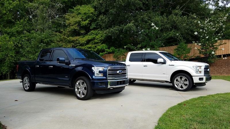

Tri-coat pearl paint jobs are pretty. Here's my brother's white tri-coat Limited F-150 he just picked up. The picture doesn't do it justice.
