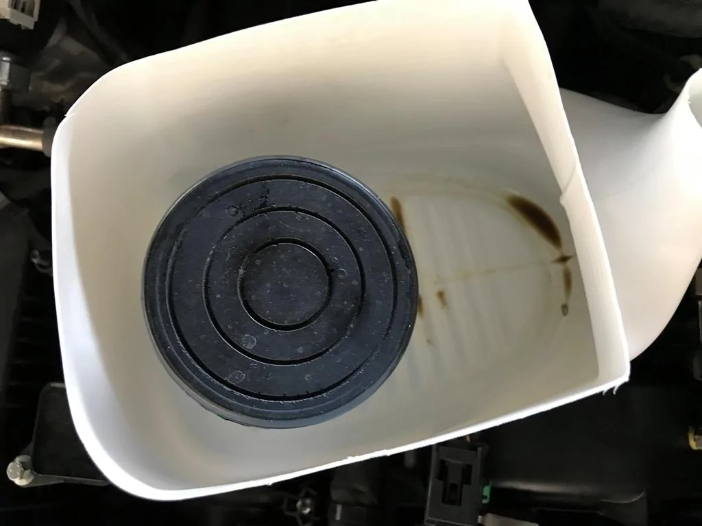

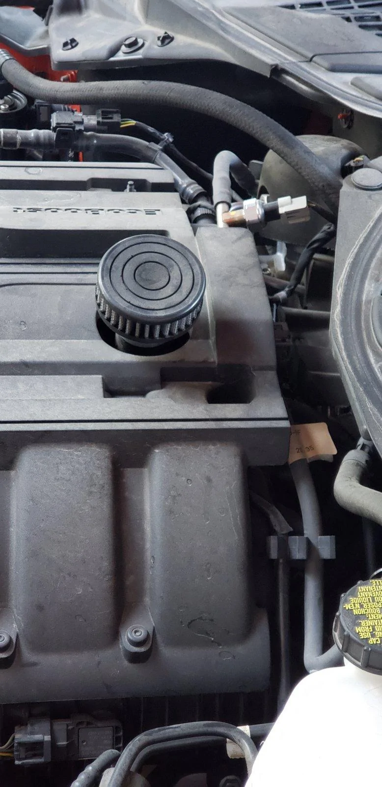

If you have UPR crankcase breather, you're probably familiar of oil/water mixture drips that coat the rear of the intake manifold that eventually drops down to the garage/parking lot floor. I tried cleaning it and while it worked for a couple days, drips came back.

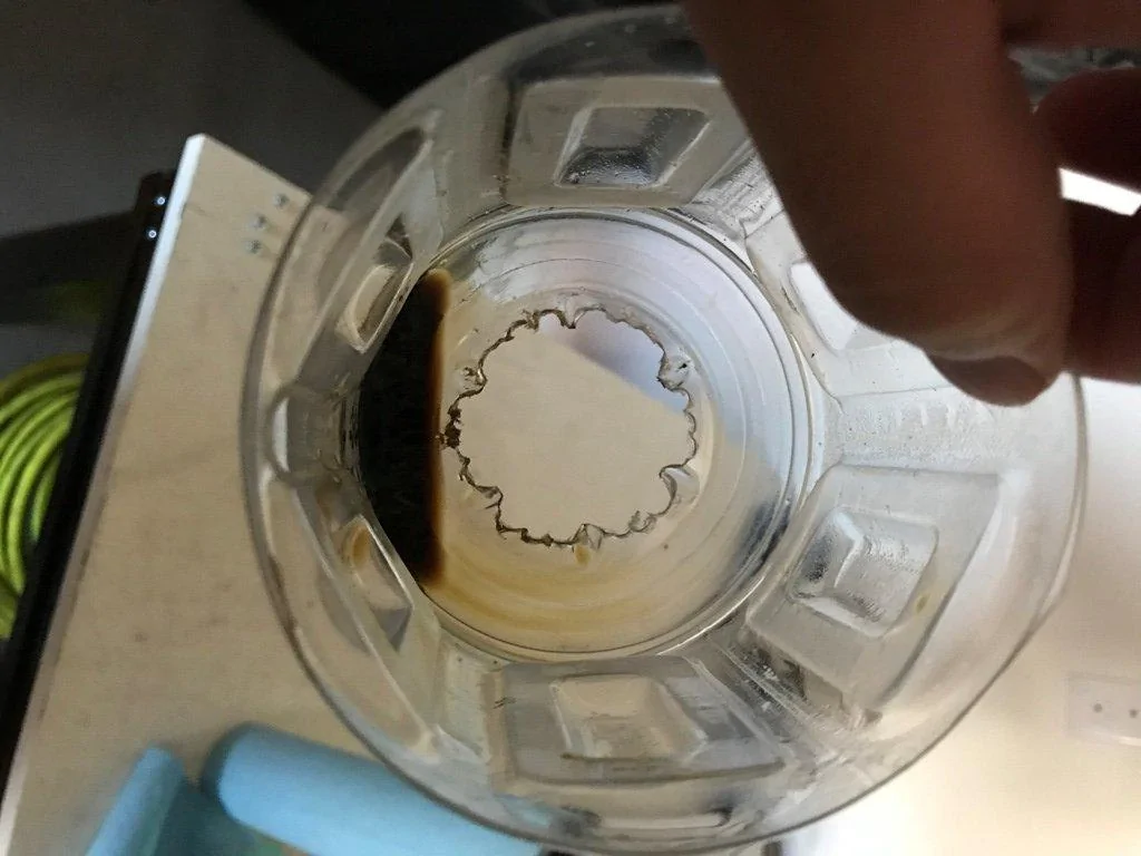

I didn't want to get rid of the breather as drips show that it's working. So I started an experiment by cutting up a Gatorade bottle to catch the drips:
The bottle worked as expected but it can only catch less than a week's worth of vapour before overflowing since it sits at a shallow angle:

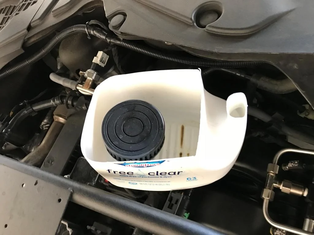

I got a hold of a laundry detergent bottle and cut it up as a replacement:
Aside from the capacity to capture more drips before having to empty it, the handle doubles as a sprout when emptying it into a used oil container:

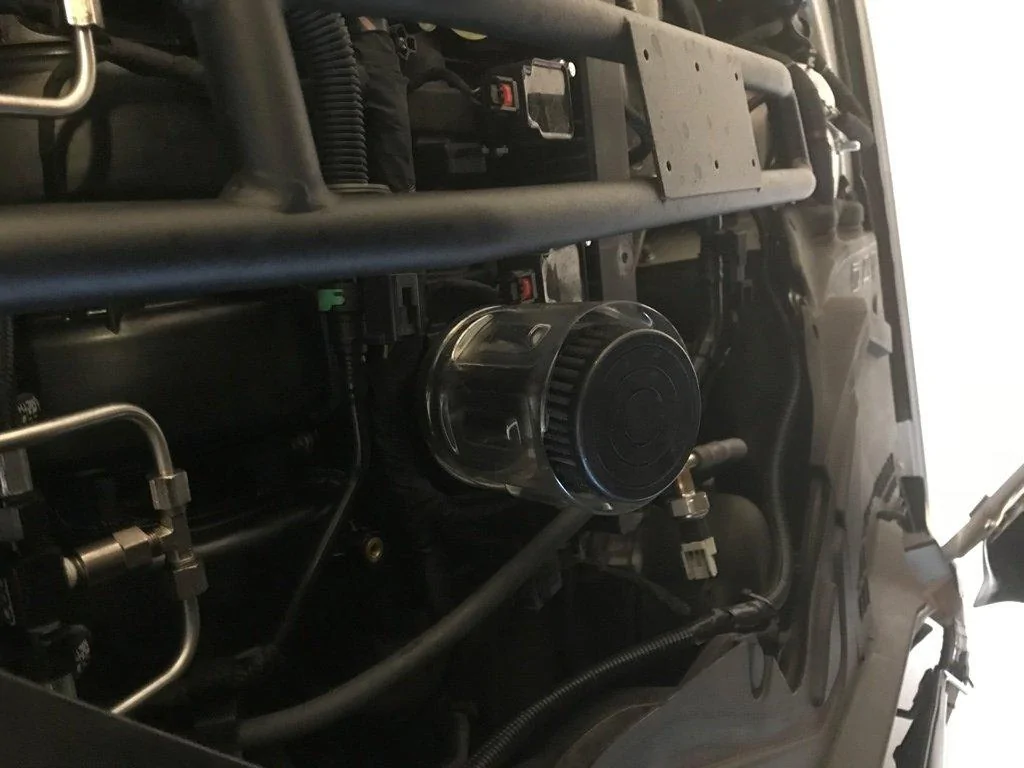

What? Are you making fun of my effort to recycle/reuse? Kidding aside, thanks for the info as it sounds like UPR DVCC itself doesn't resolve the leak. I'm thinking something similar to the blow will look good and work well if it had the metal extension on the bottom instead of the top as the drops can just drain right back.
