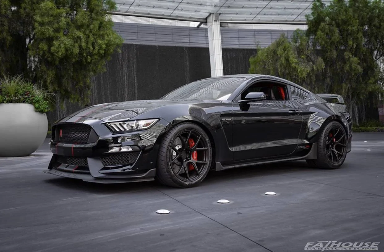

I came across the XXR 530’s and was wondering if anyone might have some input if they may fit a GT350. Fitment isn’t my forte.
I found an image of a GT350R wide-body with a set of wheels that looks kind of like the XXR 530’s (see below attached)
The wheels I’m looking at are 19*8.75 in +35 offset.
Appreciate any feedback!

Looks like they have an option to go with a 19*10.75 wheel but, the highest offset they have is +40 which is too low for the rear and most likely will poke out too much.
Any recommendations on a wheel that would work and is similar to the style in the image?

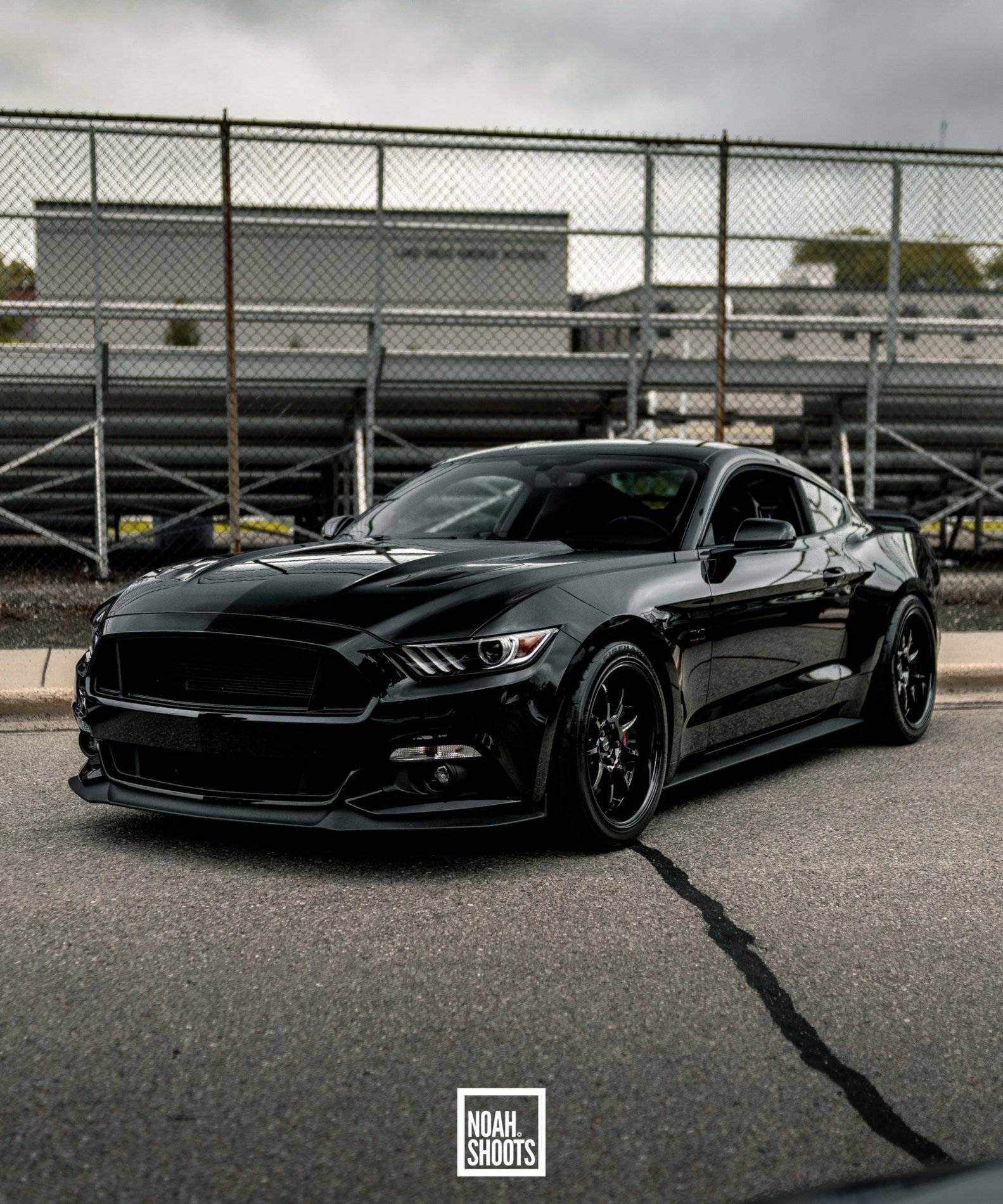

Those wheels are way to narrow. I am on a stock GT body, and run 19x10.5 +30 and I sit flush in the rear, really flush. Front sits inwards just slightly, it could really use another 2-3mm to sit perfect. But that’s on GT fenders.
You have to decide what style of fitment you want and then you can figure it out. There is an “Aggressive Fitment” thread that has a few good examples, although most in there definitely aren’t aggressive by most standards. Look through there to get some ideas.

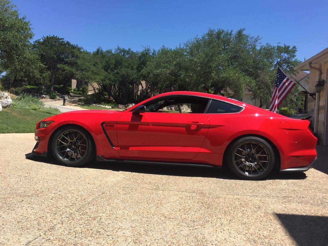

WOW @The Chairman those wheels look pretty darn close. Stance looks pretty sweet as well. I'm guessing you're on springs?
