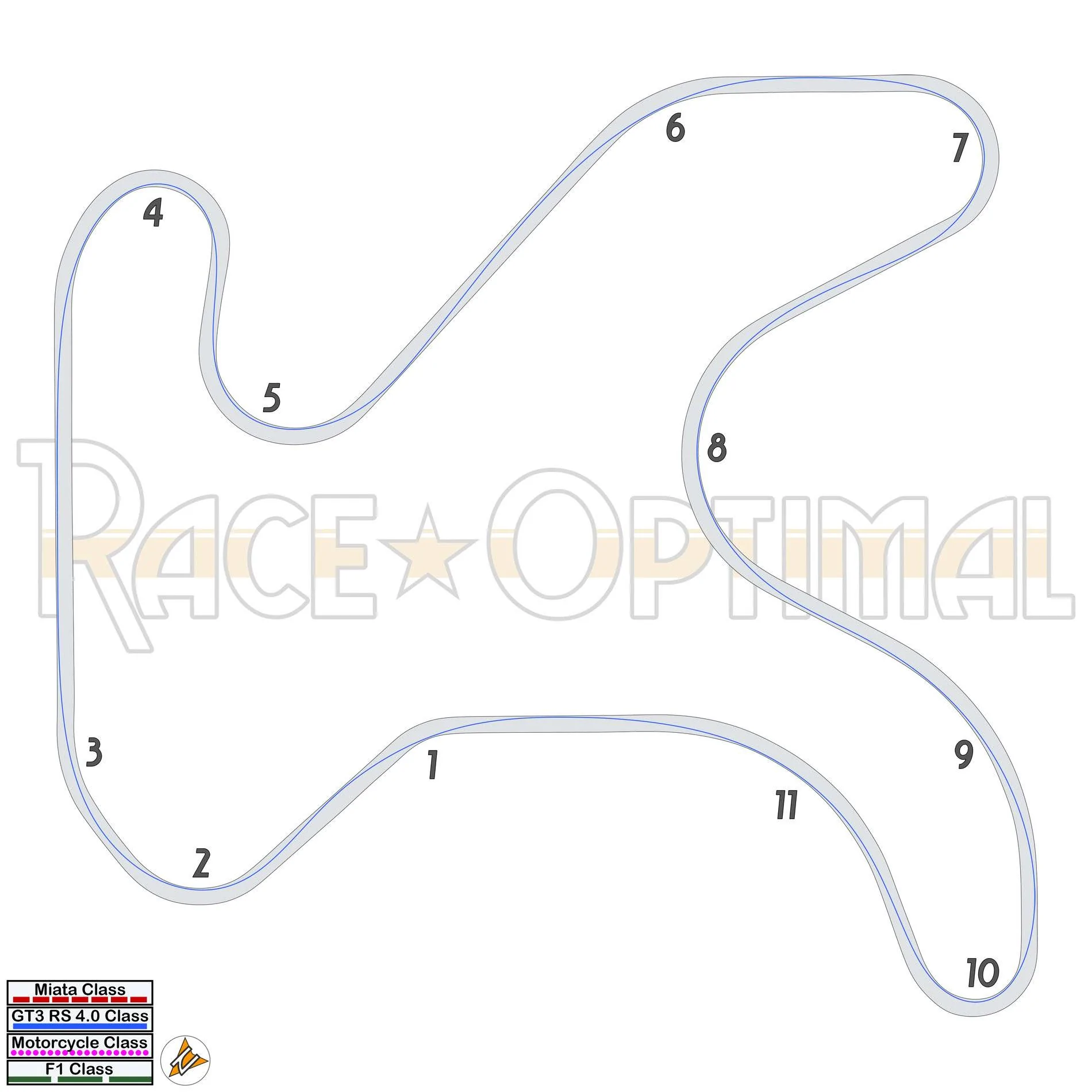

  • Track shown below with an "ideal" line for a GT3 from raceoptimal.com. Seemed like a neat service if you have no idea where the turn-in/apex should be.
