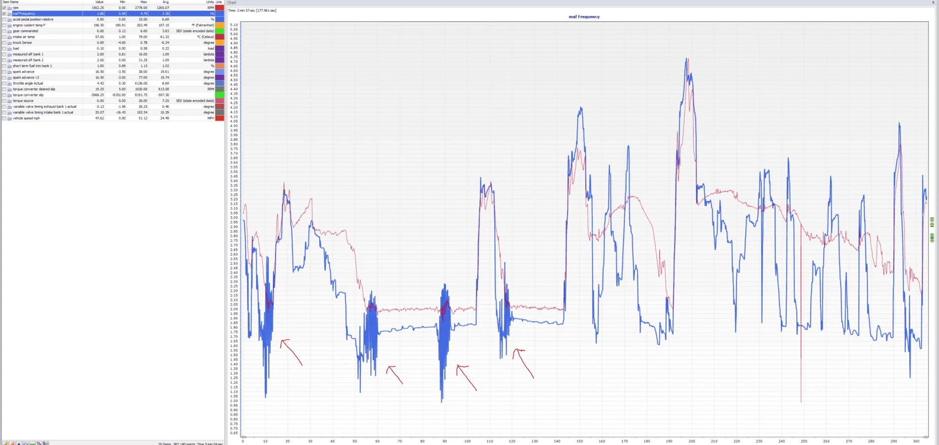

MAF sensor frequency signal looks terrible in spots then fine with nothing indicating why.
My guess is the sensor is bad. You see it best in the drive log.
It could also just be the fans blowing air on the filter causing it to be severely turbulent at times.
Need a shield for the filter, or just a different intake.
