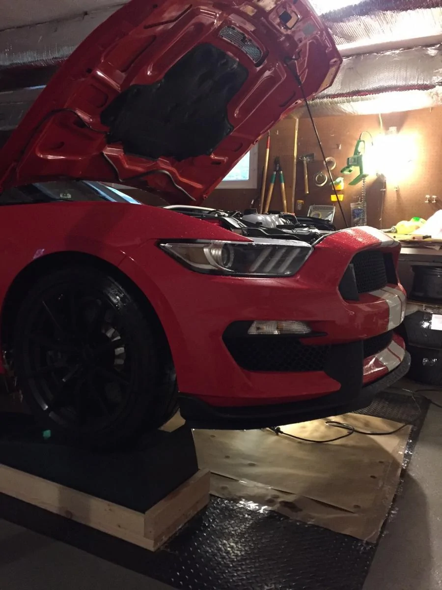

* Standard 56" or 67" race ramps do not clear the splitter. You need to purchase the extension.
* With the extension, the standard height of 8" is not enough to be able to reach to the drain plug.

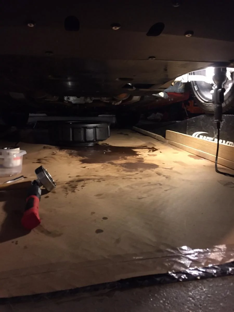

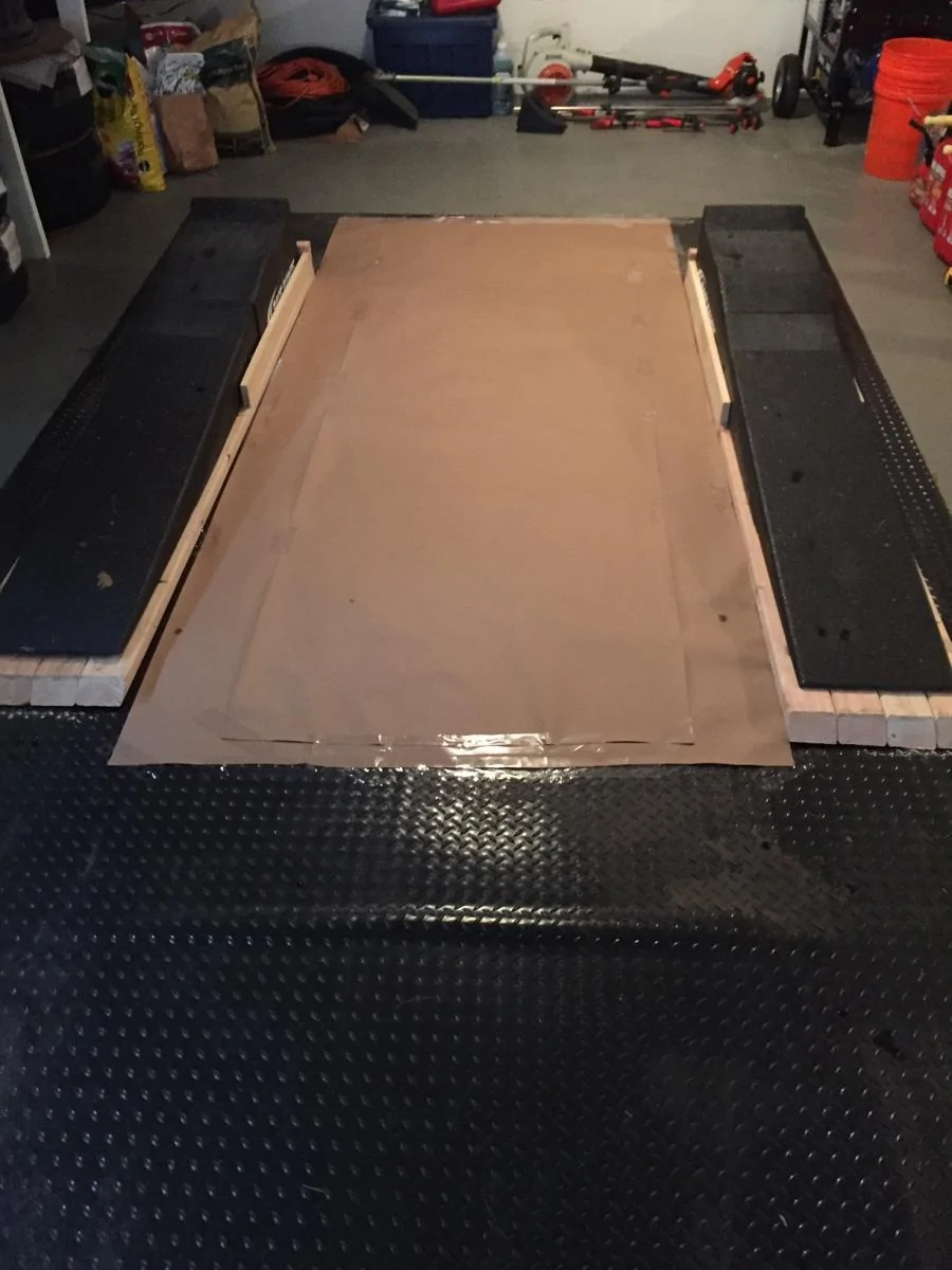

* I have built a platform (see pictures) which the ramps were put on top of which raised the lift by 1.5-2". This allowed me to reach to the drain plug but still it was an extremely tight fit.

* Pincing a hole in the filter didn't really help. I drained maybe half a quart, but when I started unscrewing the filter, I still made a big mess. The oil went over the plastic under carriage and I had to spend a lot of time cleaning it.
