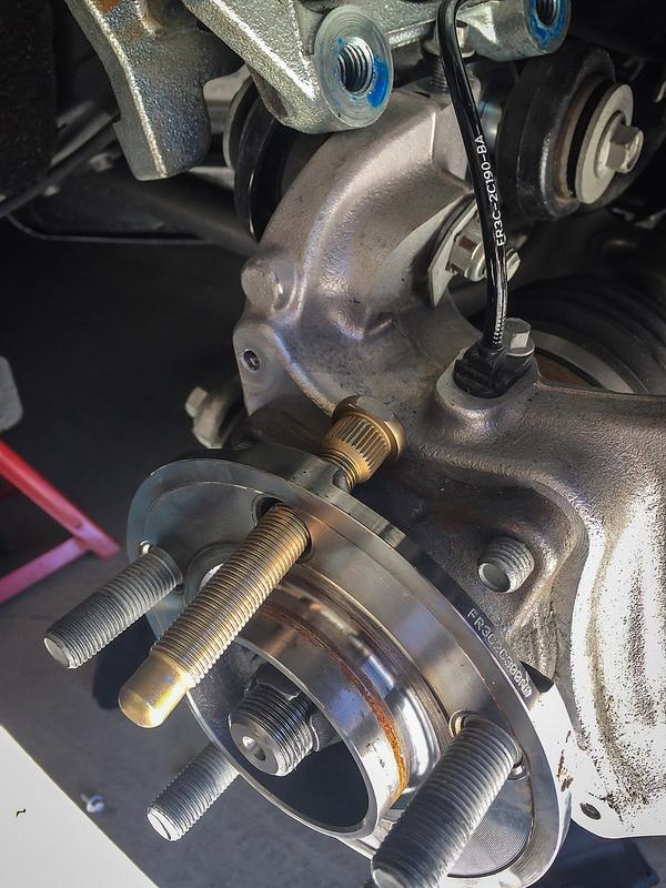

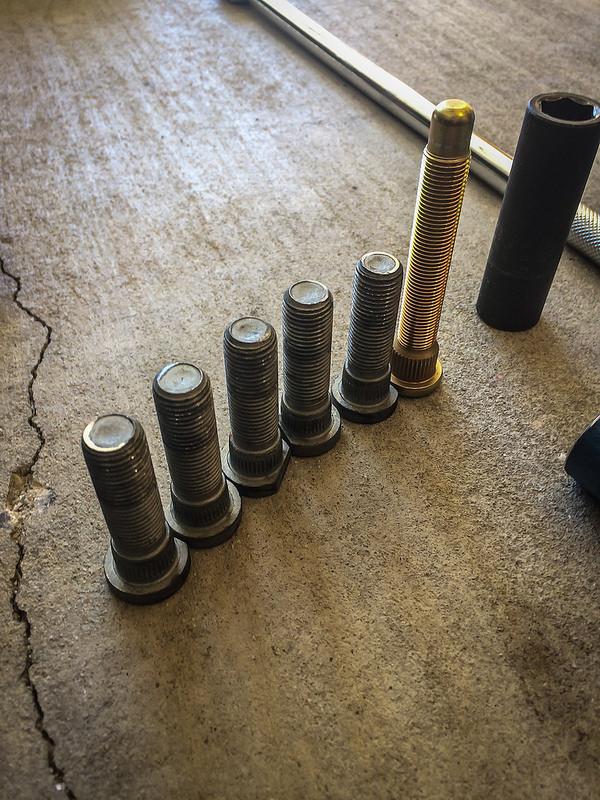

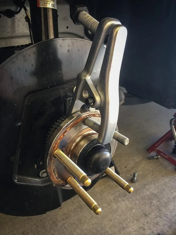

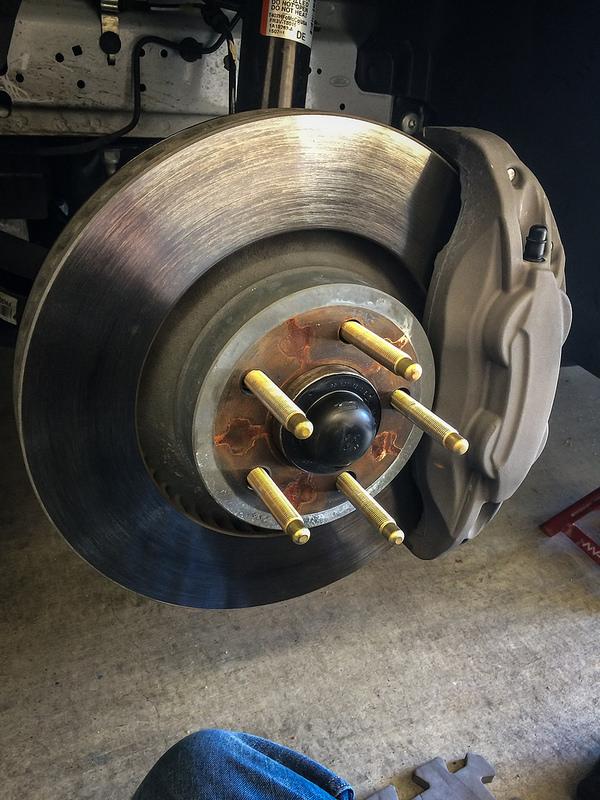

I posted this in another thread but it may not be as easily searchable and just want to help out those who decide to go the DIY install. Granted I went with ARP's 7703 (1/2-20) studs the process is the same.
Having the right tools made this job smooth and easy. There were 3 studs that the ball joint tool kept slipping on that I had to "tap" out with the mini-sledge. Being that the car was so new, those 3 studs took little effort to tap out.

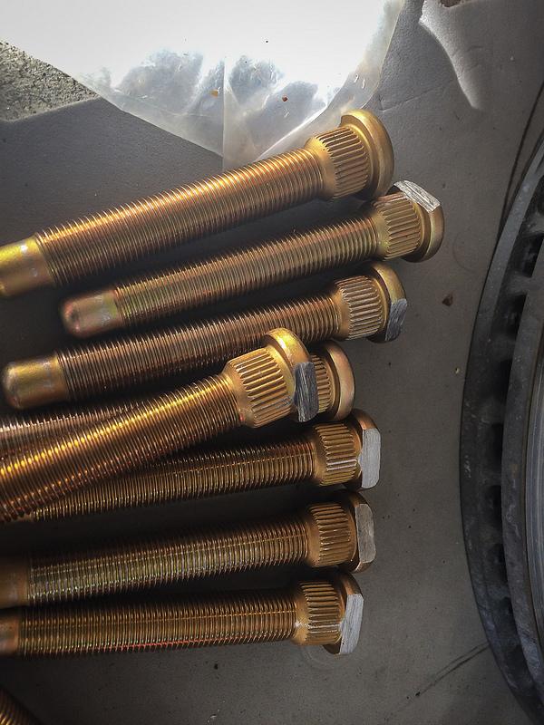

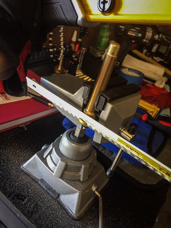

On the rears, you do have to trim the head so it does not interfere with this lip behind the hub..(I'm not sure what this part is called).
You do not have to remove the hub for the rear. This spot was the only place I could get both the factory stud out and ARP stud in. It's like a small cavern that they could easily slide in and out of.
