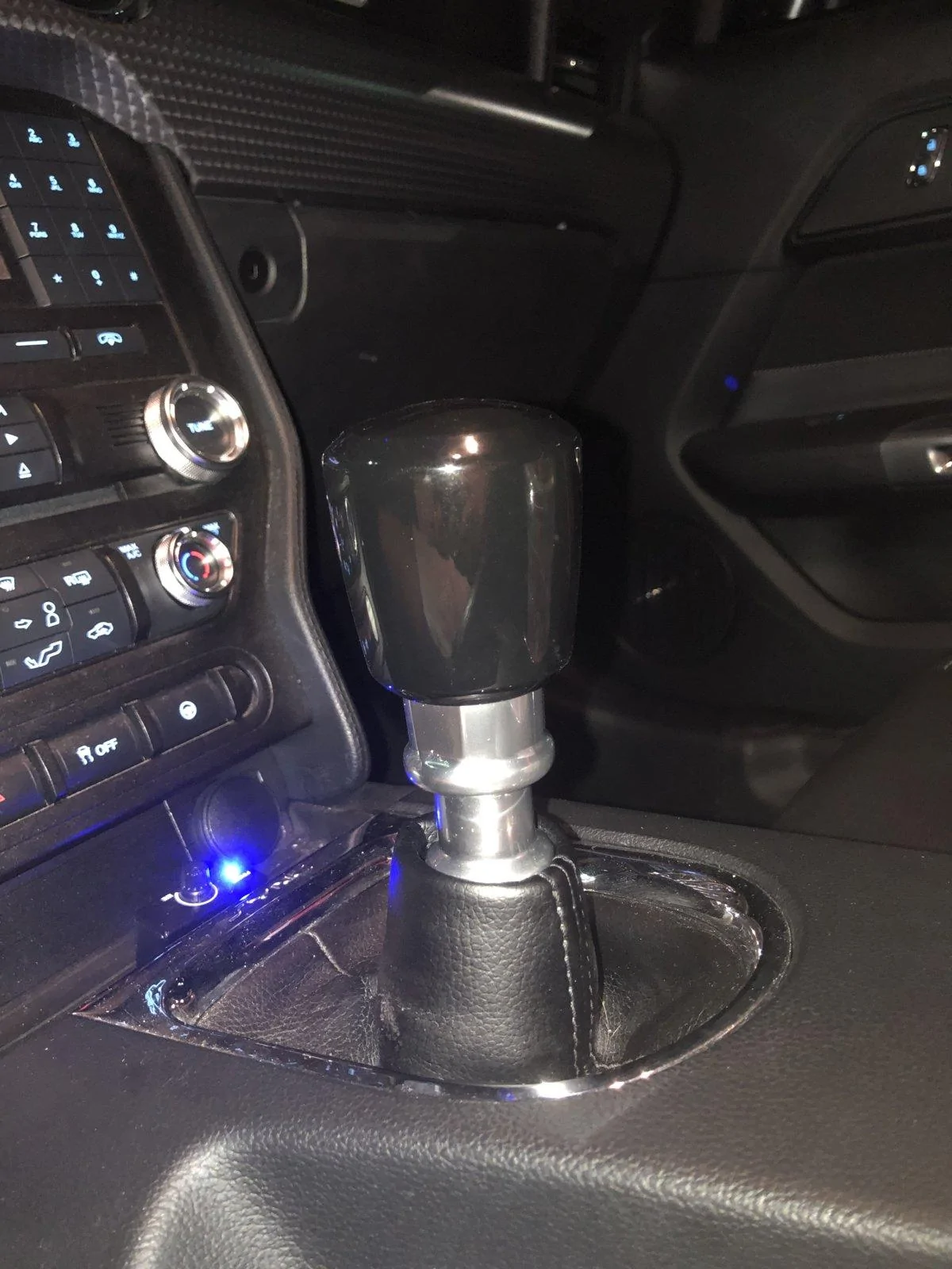

3. MGW is pretty much my decided shifter, but has anyone used one with a raceseng shiftknob? Just want to confirm I won't have any issues. It attaches to the stock shifter through an adapter that screws onto the stock shifter thread. I imagine there's an MGW adapter to retain the stock shift knob, so I assume it'll be MGW adapter -> Raceseng adapter -> Raceseng shift knob?

As far using a Raceseng shift knob with an MGW shifter,
MGW sells an adapter to be used in place of the factory reverse lockout collar, m12x1.25 thread. It's referenced in this video:
Link + description on MGW site here
You'd have to use the MGW adapter to hold the boot in place, and then thread the Raceseng adapter & shift knob.
Assuming you're not using the flat stick handle, MGW shifters are m12x1.25 so you should only need the MGW adapter I linked.

Ok perfect. I had pretty much the same thing in mind but it's always good to hear someone else thinking the same thing.
