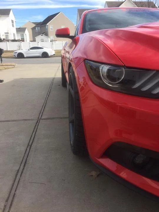

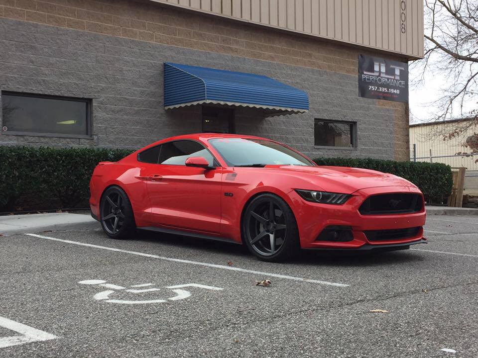

Jonas-RR-GT
Sep 21, 2015
208
134
Virginia Beach
Jonas
2015 Mustang GT Premium Race Red
I am running Velgen Classic 5 in 20x10.5 45mm offset with a 8mm spacer upfront and 305/30-20 Nitto 555 G2 SQUARE.
Suspension are Steeda Progressive springs on Performance Pack Struts and no rubbing.
