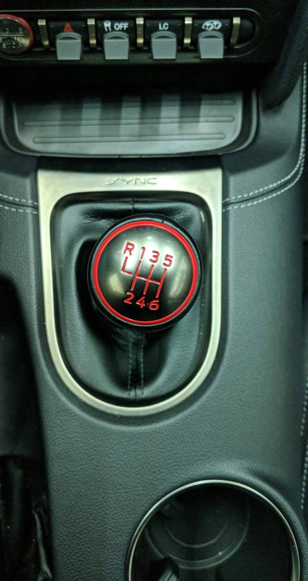

Anyone else have this issue? Are the factory shift knobs supposed to come with a jam nut? '19 350.
That makes sense, thanks!No they are screwed on with loctite. If you can loosen it all the way off you can reapply blue loctite and set it right.
