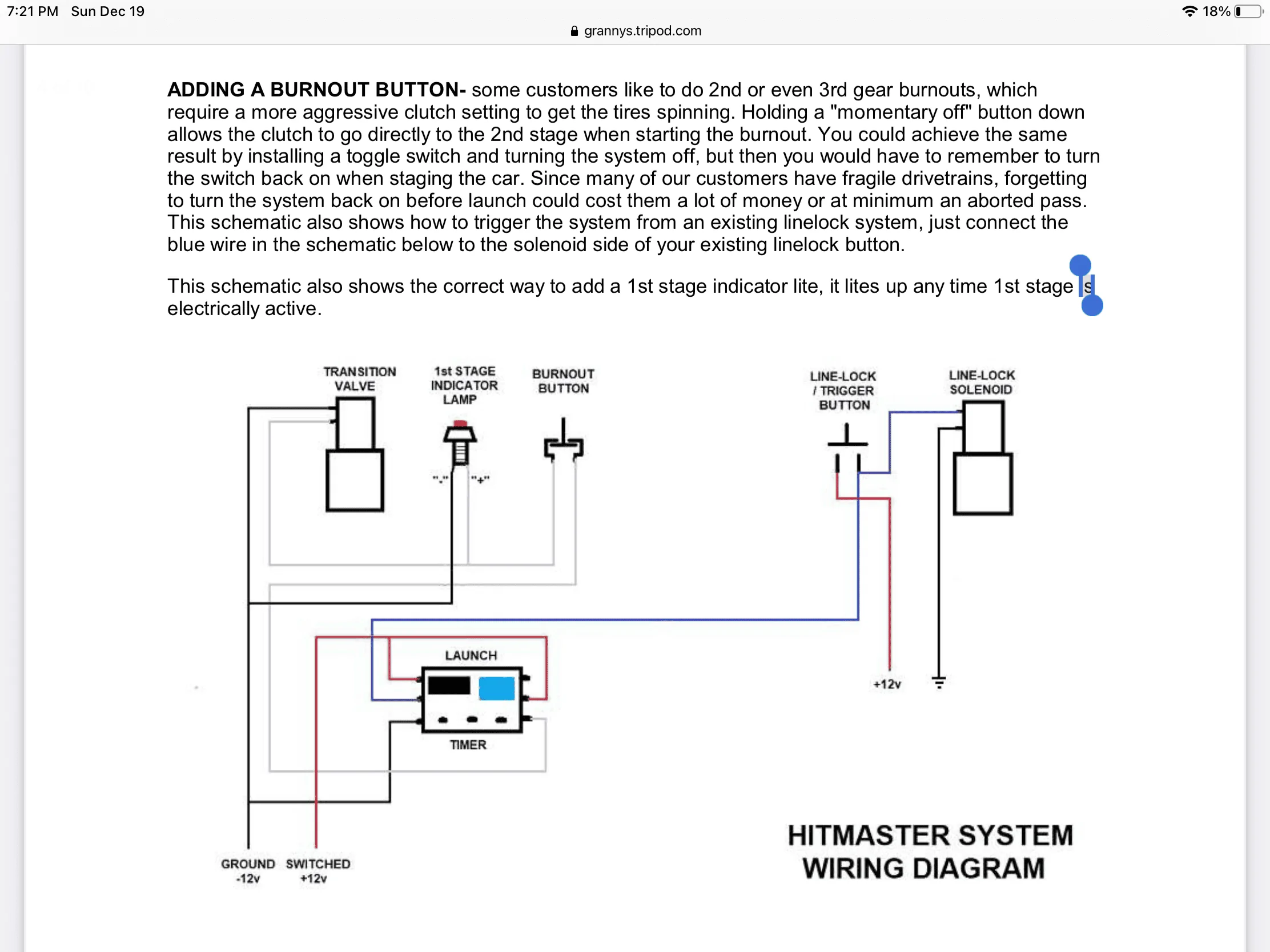

Does anyone have the factory ABS/line lock wiring diagram for a 2018+ GT and/or 2019 Bullitt that they can post here? I am trying to ascertain information on how the system is wired and possibly tap into it for an upcoming Clutch Tamer mod. Here is a diagram from Clutch Tamer showing the wiring for a Hitmaster 2 stage setup. Any help thst anyone can provide would be greatly appreciated. Thank you!
