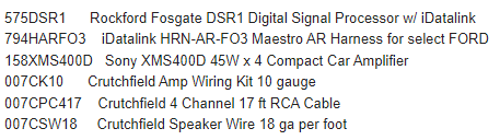

For future reference, here's a complete kit for this job (if this is an amp of your choosing):
