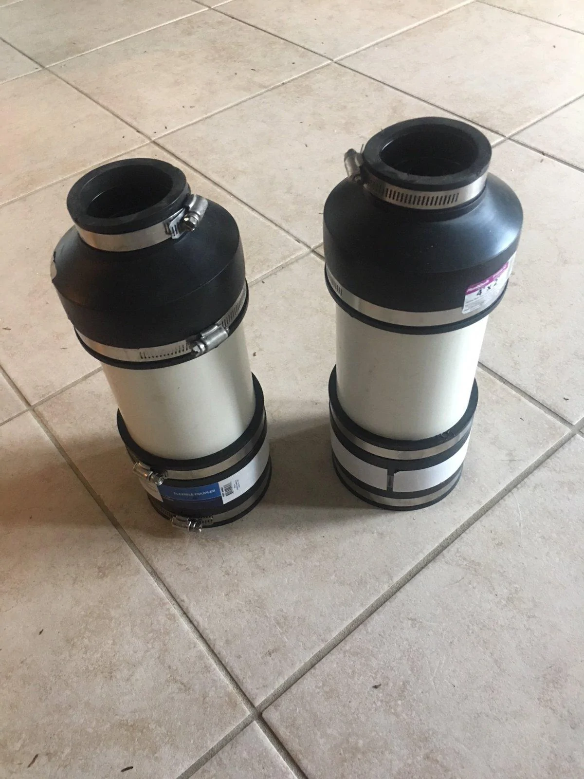

After talking to Msweet on the Australia forum I decided to make these silencers. I love my Roush/X pipe combo, and it's fairly quiet at idle once it warms up, but the cold starts are pretty bad. I went a slightly different route than his with the interior packing and end caps. What I did was use a 1" by 5" motorcycle muffler baffle and wrapped it in steel wool, and on the interior side of the PVC pipe I added a 25" layer of foam for some additional sound deadening. They will only be on for a few minutes at a time so I'm not too worried about heat. I also used a 4" to 4" rubber adapter for the muffler tip, and a rubber 4" to 2" adapter for the end cap, which should silence it a bit more over a plastic end cap. I just tested them out and they make a huge difference and really take the initial "bite" out of the cold start.
A few questions though, should I be worried about too much back pressure? Other than backfiring, would would be an indication that they are not flowing well enough? Also, I noticed when I started the car, the fan kicked on right away, however it's been sitting out in 85-90 degree sun all day. Is that normal? I never really payed attention. Obviously, these will just be on the car for a few minutes at a time when it's first started.

Looks funny, but works.

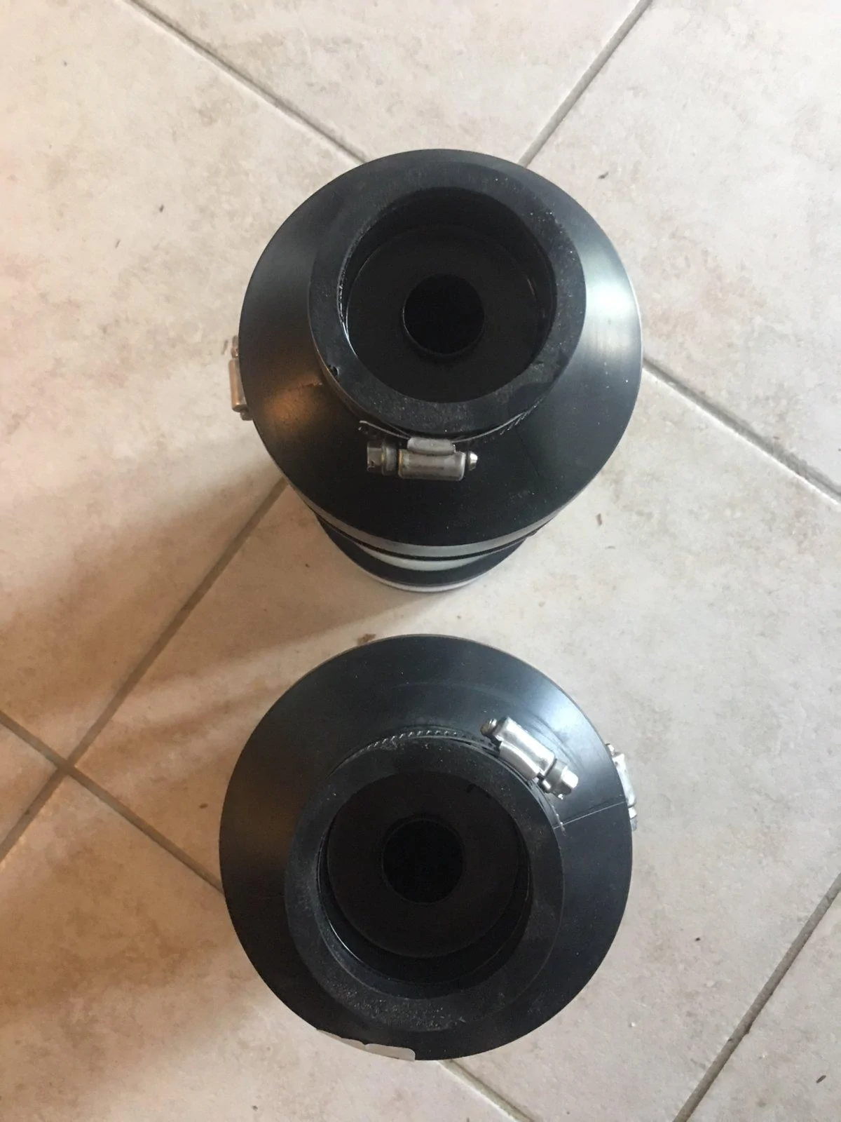

You can see the motorcycle baffles in this pic.

As for size and parts -
I went with 4" PVC pipe, cut down to two 8" sections.
I used 4" to 4" rubber couplings for the tail pipe side (The Roush is a 4" tip), and 4" to 2" rubber couplings for the exit side.
For the interior of the PVC I bought a 1lb roll of steel wool on amazon, and two 1" by 5" exhaust silencers which I wrapped with the steel wool.
For the interior of the pipe I bought some .25" neoprene foam sponge rubber adhesive which I lined the PVC with. It might not be need, and I don't know how well it will hold up, but I figured it would add some additional sound deadening.
*****msweet who made one of these last year used a rubber type plug with holes drilled for the interior of the PVC instead of a baffle and steel wool, however he's in Australia and I could not find the plug around here, so I went with the basic muffler style baffle and steel wool build instead.
The exhaust size coupling fits loose, so it just sits on the exhaust, if there were any back pressure it would just knock it off, which is what I want. I may try a slightly longer but 2" baffle wrapped in steel wool to see if I can get the same quiet tone but with slightly more flow, however the 1" seems to flow fine so far. You can get everything you need on Amazon or at any hardware store. I'll get some pics later of the interior. They only take a few minutes to make once you have the parts. It's a really simple build that does seem to take care of the annoying cold starts.

4" diameter PVC pipe, cut them into two 8" length sections.

This is the baffle I used inside the pipe. They're $8.99 on Amazon.
