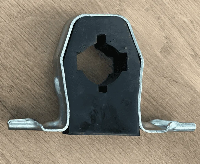

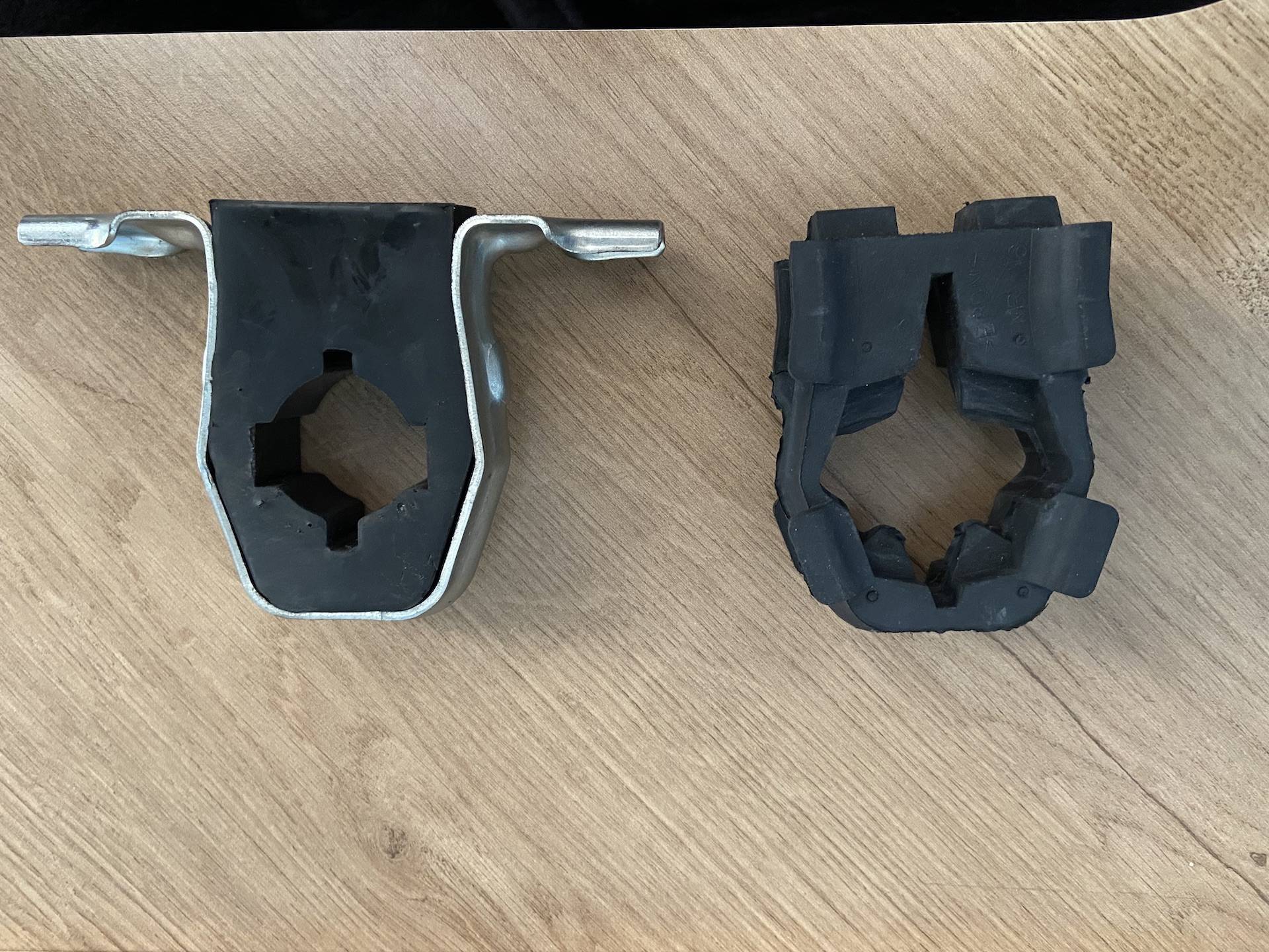

Rear shifter to tunnel mount, Ford OEM marshmallow on the right.
The left Ford OEM bracket with Energy Suspension Polyurethane insert. 40 bucks

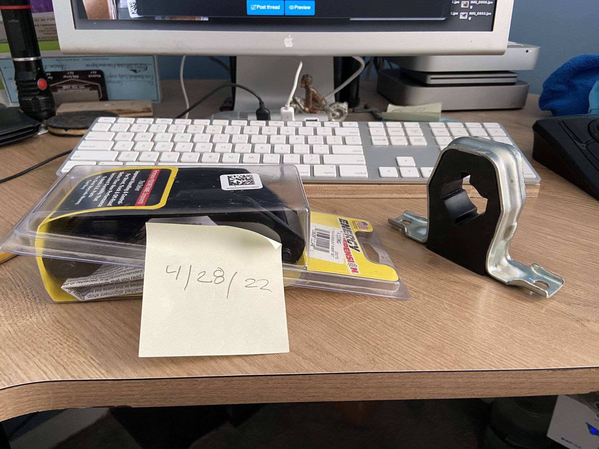

Next
New in the box is, Energy Suspension Polyurethane insert for the Trans mount. 40 bucks
Next forum compliance photo will ship @ buyer's cost, both for 60 bucks

How flimsy is that stamped metal bracket?

Not flimsy at all, you won't twist it by hand, that factory bushing is the bad actor.

Much appreciated! The steeda bracket always looked more robust but now it just seems overkill.

It is, the real fix is replacing the bushing. I ran that for a year and got lucky, finding the BlowFish .

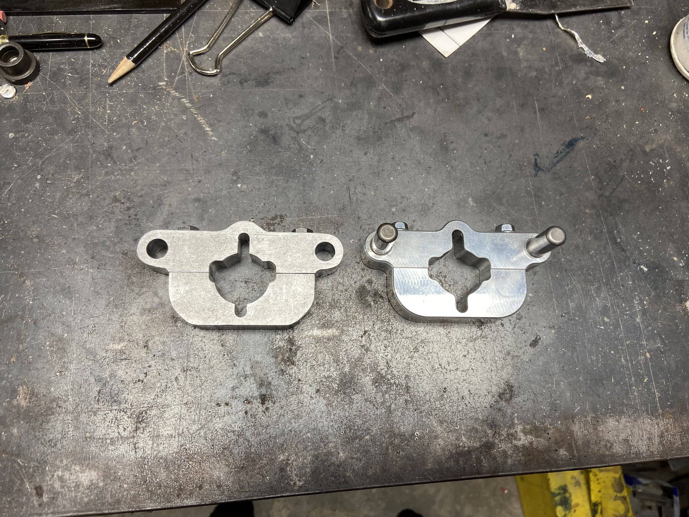

Nice, the blowfish is hard to find. I've wanted to make a copy at my work, we do sheet metal fab so if I had the dimensions we could sell this to people lol.

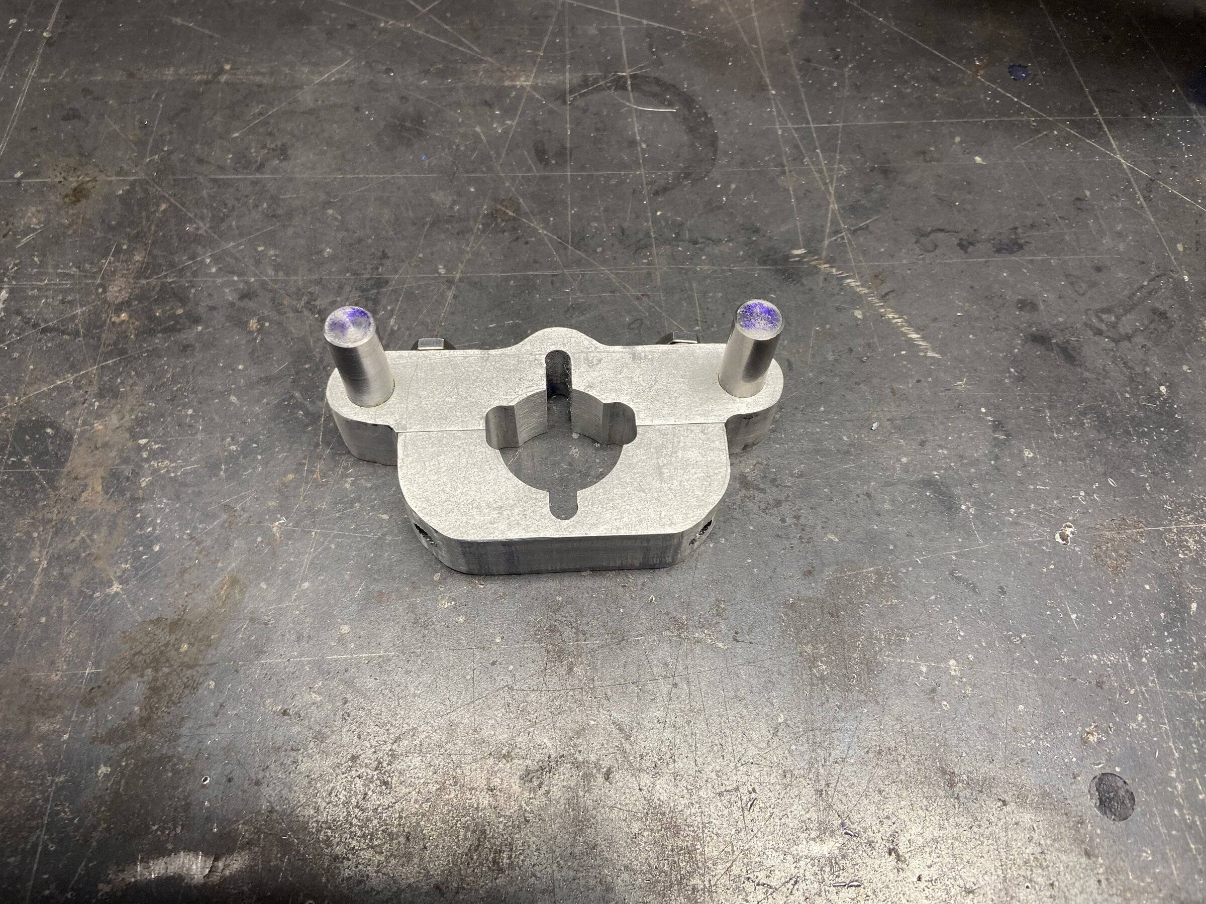

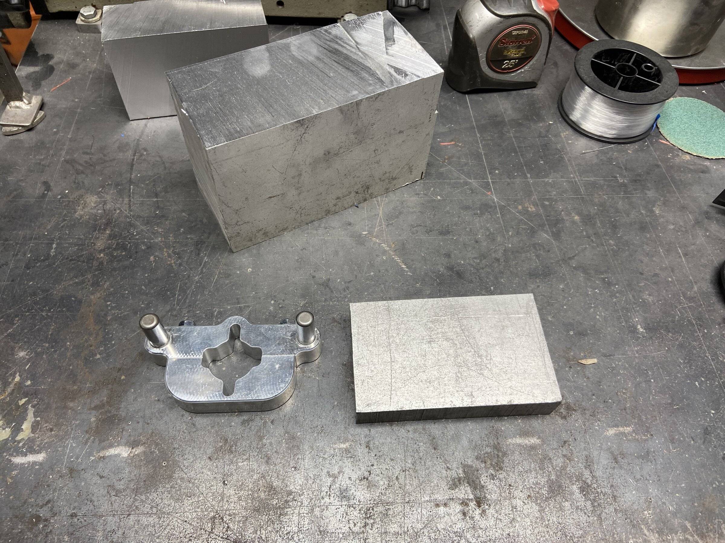

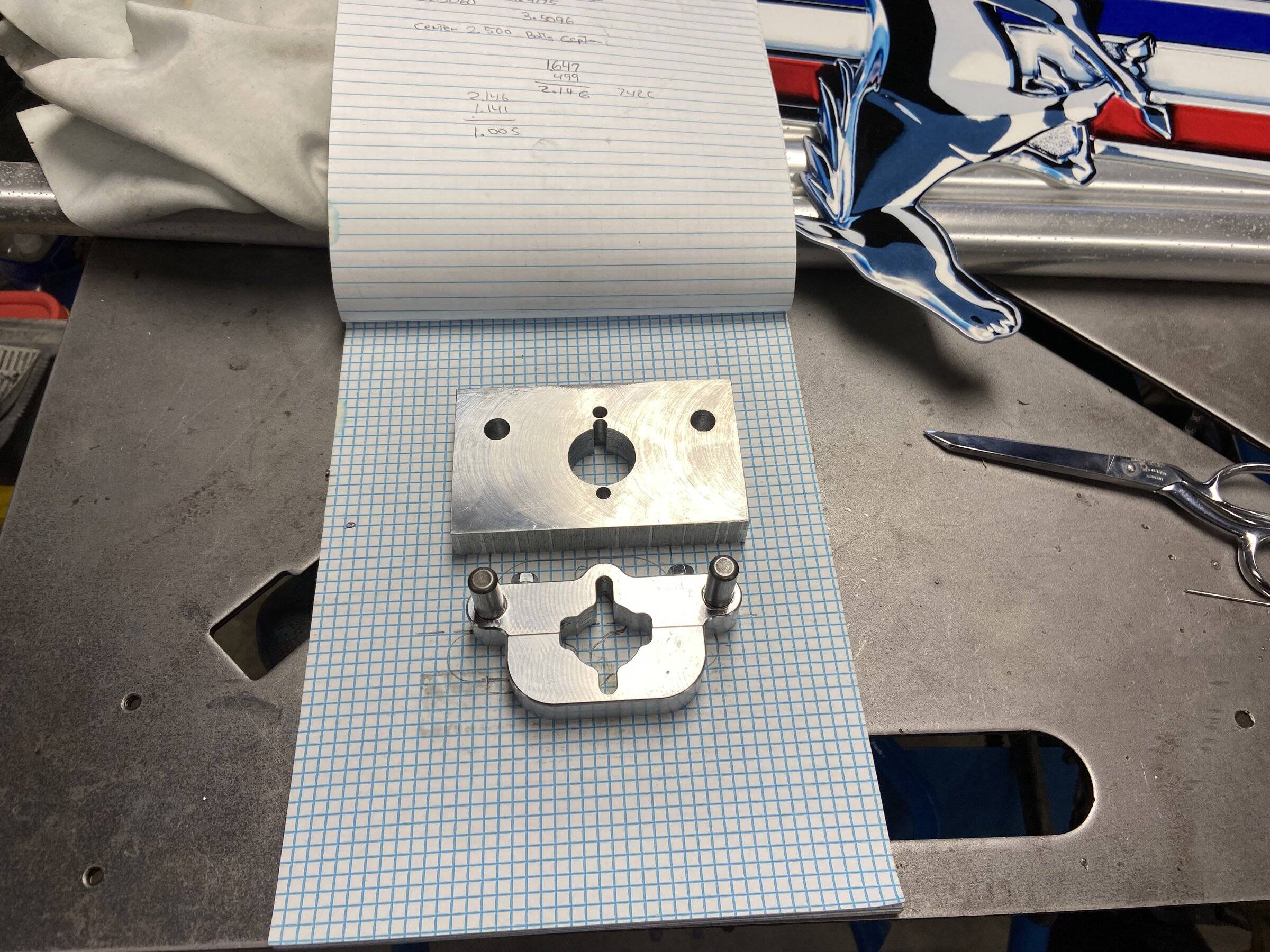

That thing is 1/4, I wound up with 2, trans brackets and one shifter clamp.
So I made it.

Nice! Did you install these already? how does it bolt up to the factory threaded studs?

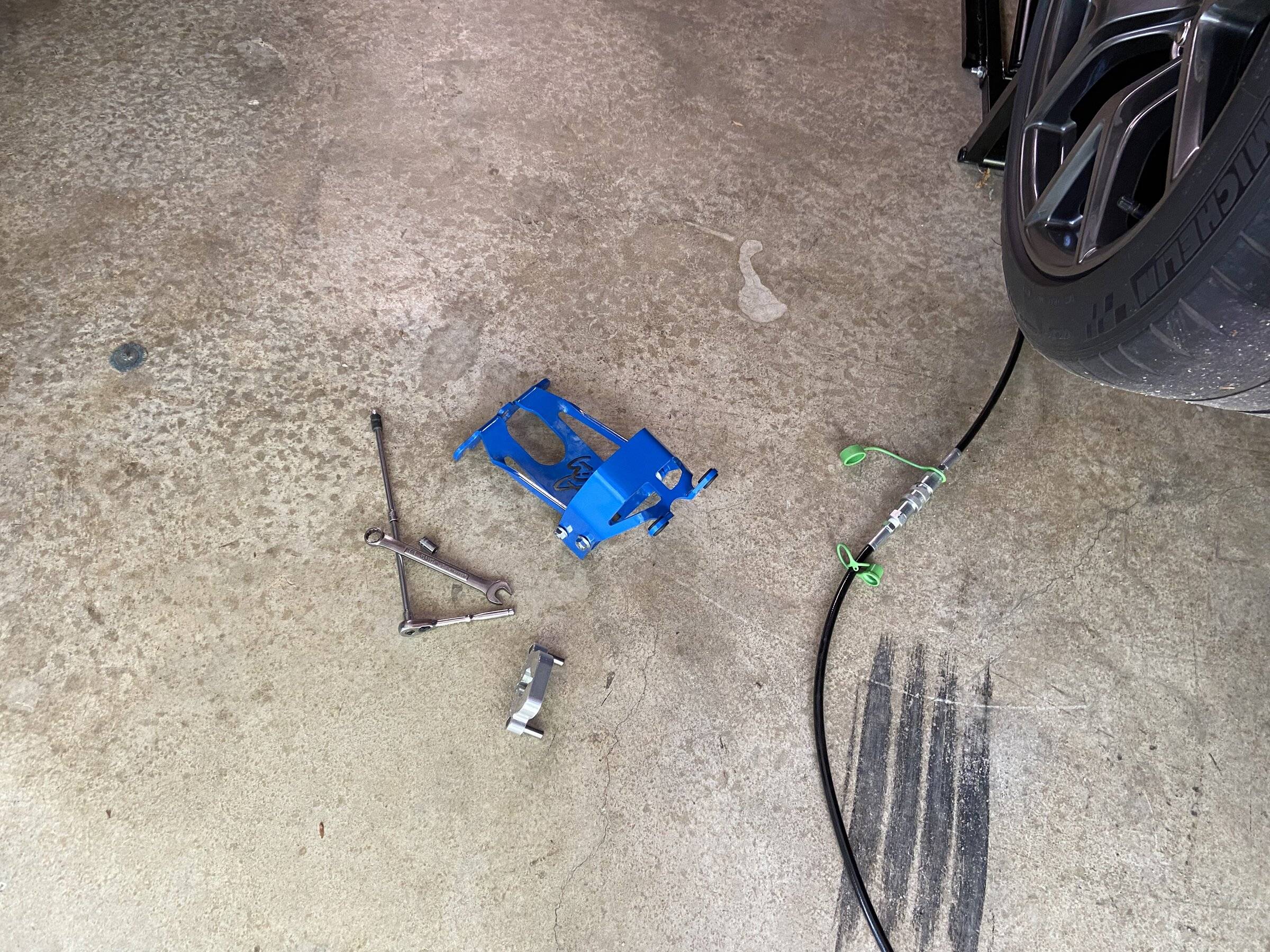

Sorry not following the question, the clamp goes on the backside of the factory shifter. The picture was before the pins were installed.
replacing this part
